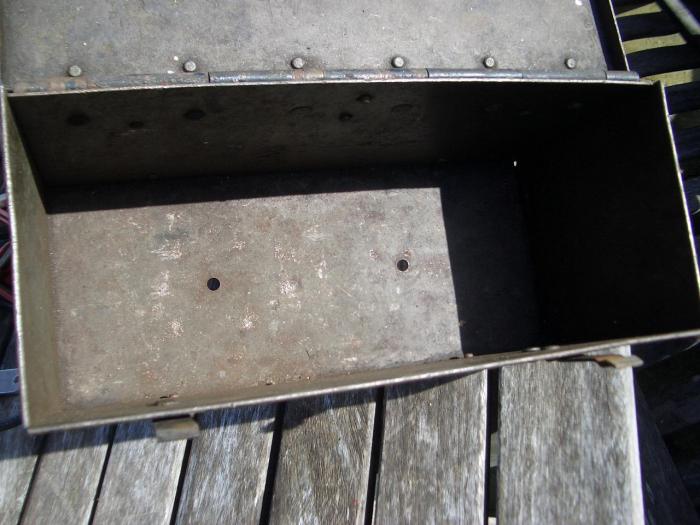

Jordan, a couple of things on the smoke generator bin. First, I assume this carrier is missing half the upper wood filler and it's not meant to have only half round holes at the top? Second, what do you make of the angle iron bracket under the bin that raises it up so high? Have you ever seen that before and do you think it's correct? (I've never seen anything like it before).
Old 16-01-13, 06:50
Posts: 4,192
Bruce. Thanks for posting a different link. Not sure why mine didn't work
As for the bin. No I disagree. The two original bins I've seen only had small wood screw holes on the hinge side of the bin. To me this suggests that the upper level was only a half and on the one side. It makes sense also as it would be easier to lift out the rounds by grabbing the side.
Hopefully my explanation makes some sense.

As for the side cut outs in the generator bin. As I understand it they were to hold tins for the special .303 grenade launch rounds.
I found this link that has some pictures of what those tins might look like. Thoughts?
http://www.milsurps.com/content.php?...nd-Dischargers

I thought the box was for 4" smoke bombs not grenades! I can see that they must be fired in a similar way using the 303 round but what does a 4" smoke bomb/round look like?

Hi, Thats a very nice original looking carrier, It would be nice to see behind the rear tool plate to see what support the towe hitch. Also I wonder if they have an original wood seat arrangement over the right gas tank for it?. Proof also about the rear batt box black pitch/rubber paint. Nice grenade box interior. It would be nice to get a history on it, might have been stored up as an original un-issued carrier?. Only reserve is the fire extinguisher holders?. Anyone notice the rear can holder wooden insert in the bottom?.
A couple of pics of an original smoke dis box.
kevin.
