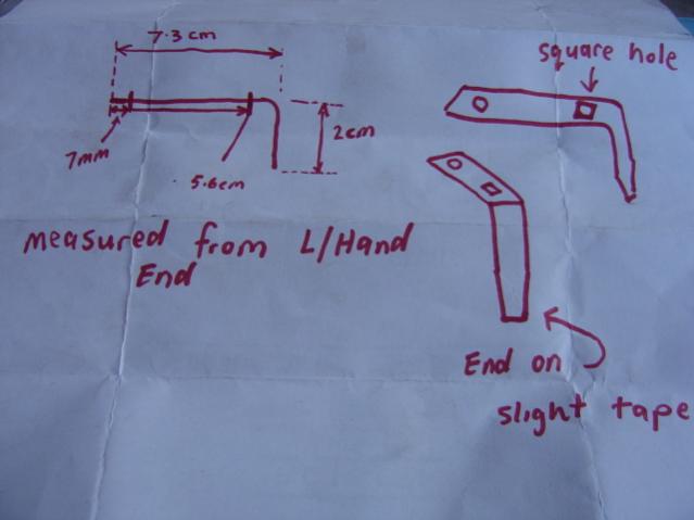

I copied my lever from a NOS one, didnt take any measurments at the time so just had the pleasure of doing it in place (cheers to everyone who has done this for my requests), hope the photos and measurments help. I had heard that there was a second type of tap for NZ LP carriers but I have not seen one.

Thanks for the drawings and photos Lew, although it sounds like the 'L' shaped lever is for the valve type that is different from mine.

Thanks for the photos of the lever Nathan, should be easy enough to make.
