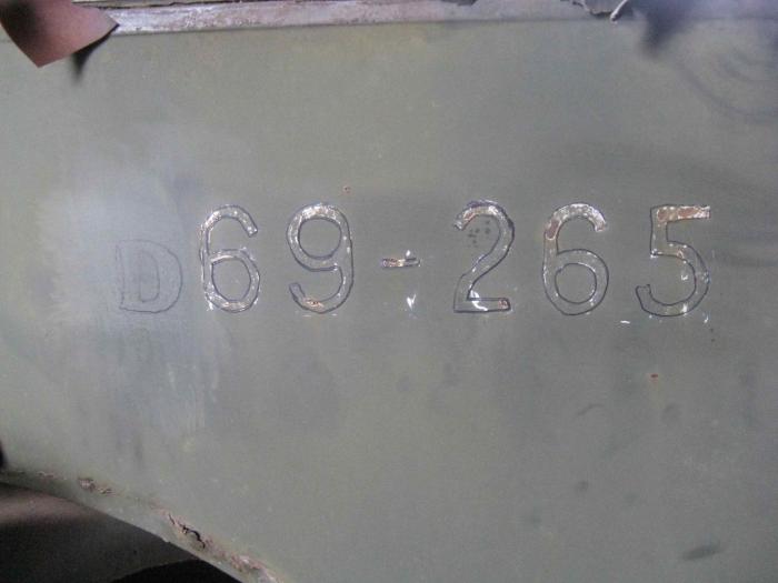

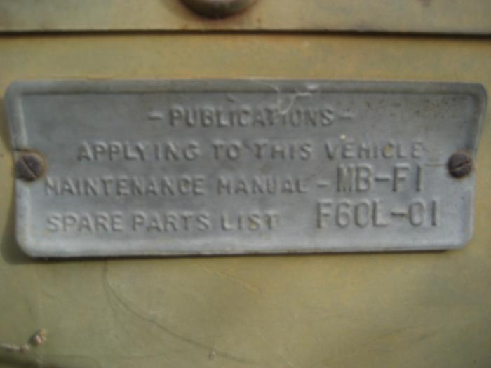

Here are the original markings found on the doors of my Ford 3 ton cab 13 CMP.With some searching I finally found a tag on my steering box with a date 1-43 so I now know when it was built.We had discussed these markings on my door in the past but I would have to search back to see what was said.
Derk.

The top line, A 19 CASCTC is for A 19 Canadian Army Service Corps Training Centre, originally organized in 1938 as Permanent Force Training Centre 1. It was alloted the A 19 designation on February 15, 1941.
Old 12-06-13, 14:48
Posts: 7,644
A-19 will be the designation for the Canadian Army Service Corp Training Center that the truck belonged to. L is for Lorry, and the remainder is the DND number assigned to the truck.
The date on the steering box is a casting date. It may have been a while before that casting made it onto the truck, so that may not be the best way to date the vehicle. It is also possible the steering box got changed out at some point. However, since your truck has the holes for the bumper reflectors, and does not have the FORD script on the cowl, that date is possible.
