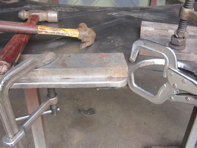

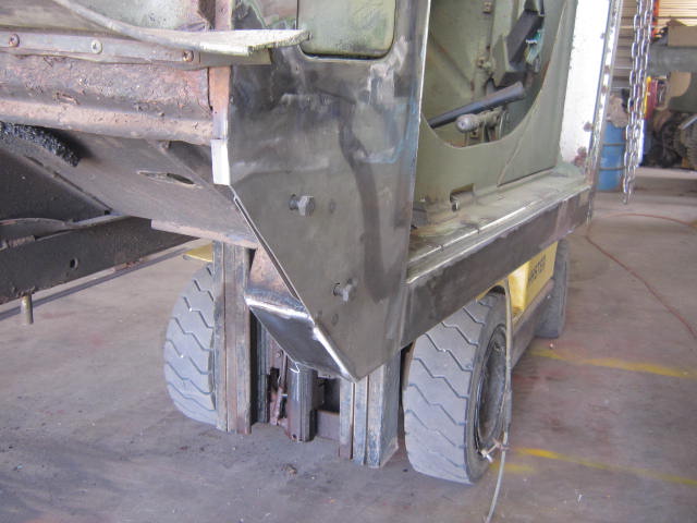

I had to form the bottom of the panel so I got a piece of 300x12mm plate and cut the shape of the bottom of the panel. It's not perfect but close enough.
M52A1x7 001.JPG   M52A1x7 002.JPG   M52A1x7 003.JPG   M52A1x7 004.JPG   M52A1x7 005.JPG
Old 20-11-13, 11:49
colin jones's Avatar
Posts: 1,810
I clamped the panel where I thought it was correct and slowly peened the sheet over the edge until I achieved a right angle the entire length which strengthened the bottom considerably.
