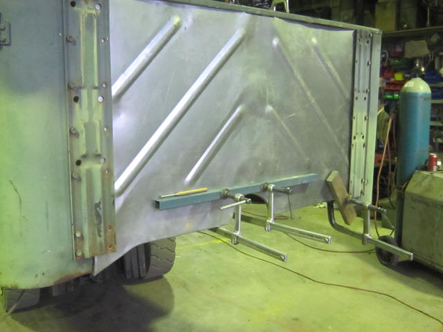

All the original panel took me about 2 hrs to get off and about an hour to roughly fit the new panel in place. As I said before, it's not perfect or pretty but I'll live with it. I still need to do the holes and weld it in place.

Hi Colin,
Thanks for sharing! It is quite inspirational and gives alot of us some great ideas about how to do things!
Can you elaborate on this one some more now?
'It has stretched a bit here and there but I think I can fix that problem.'
How did you fix the stretching as it doesnt seem to still be too stretched when we now see it 'fitted up'.

I clamped the panel where I thought it was correct and slowly peened the sheet over the edge until I achieved a right angle the entire length which strengthened the bottom considerably.
I do like your custom ball-pein claw hammer Colin
