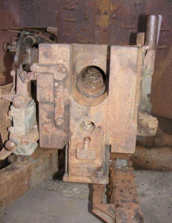

Instantly an inspection begun. We were really lucky as the gun was in very complete state. There were some scars, the barrel, breach block and recoil housing were punctured, the spare parts box rotten through, but everything else in good shape and easily restorable.
stavpred 015.jpg   stavpred 034zmen.jpg   stavpred 035.jpg   P1271959.jpg   P1271960.jpg

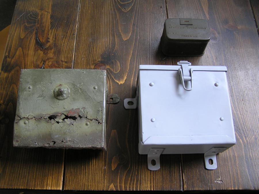

We had to make a new spare parts box for the shield, the original rotted away...

Default 6 pdr spare pats box
few more pictures. By the way does anybody know what the box should contain?

Hi Dusan,
Yes, I do. The rectangular hole is for the little tin with spare springs, split pins and other assorted small parts. I have a list in one of the handbooks that tells what exactly. These tins come up on Ebay regularly. The round hole is for a spare firing pin, possibly with the spring but have not yet tried to fit it.
