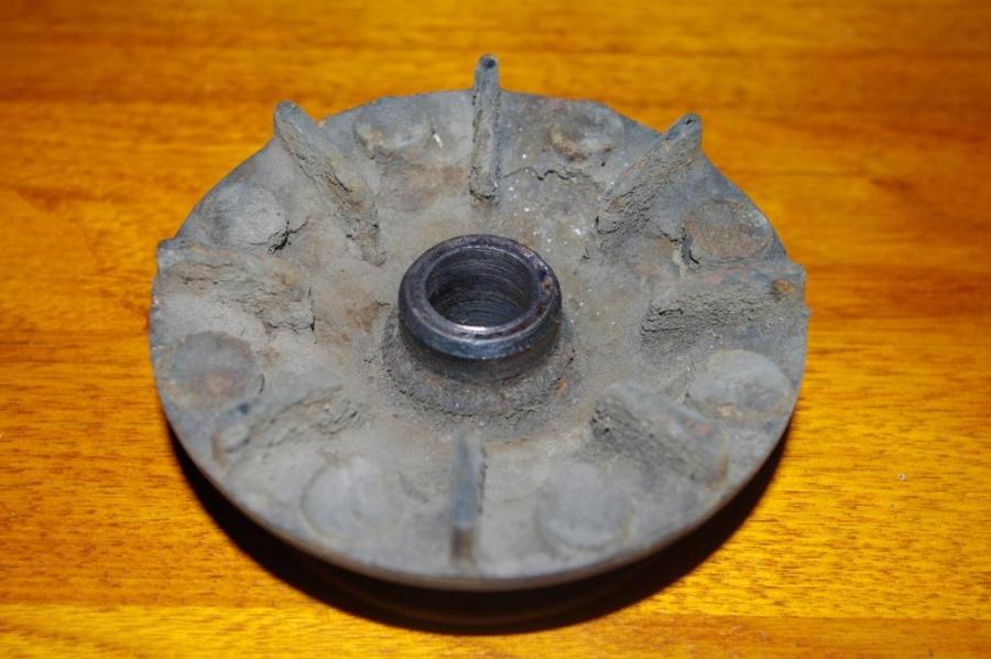

Default URGENTLY - Fan Pulley Ford Lynx 12V Generator
Fan Pulley for Ford Lynx. Part no.10130.
As circled in RED.
The Ford Lynx has a 12volt electrical system and the generator has an unusual pulley. It screws onto the shaft (20tpi) and is held on by a cir-clip type of fitting. Most Ford of WWII are 6 volt (but not the Lynx which is 12 volt) and slide onto the shaft and have a keyway and held in place by a nut.
Measurements are shown on the attachment. Drawing not to scale.
Old age has caused the original to shatter into many bits.
Thanks Rick
Don't know about the single belt pulley found on Ford commercials but the twin belt pulley on Ford CMPs is a screw on type. I'll have a look amongst my genny bits and see what I can find.

I believe this is the same part Rick, let me know and I'll stick it in the post tomorrow.
Tony, Tony, Tony you are beyond words. Thanks Mate, it looks to be the right one. You have my address.

No worries Rick, I've accumulated quite a variety of generator pulleys off my Ford CMP wrecks! The only real scarcity amongst them is an original CMP pulley! Or at least one without large chunks missing or several vanes busted off. I discovered this when trying to rebuild my own genny recently - the only spare twin belt pulley I could find was much smaller than the standard CMP pulley. This led me to consult the parts list, whereupon I discovered there were in fact two different diameter pulleys fitted, nominally 3 1/2" and 4 1/2", the explanation for the smaller one being: "Use where low cut in speed is desired." What this means off course is heaps more fan noise at cruising speed, so these are to be avoided I'd suggest - although perhaps it may offer a solution for overheating problems. Anyway it's worth knowing about so I thought I'd mention it.
BTW Rick I only have your PO Box address, I assume that's where you want it sent....? I've given it a quick scrub for better ID, which I probably should have done before posting pics! As you can see the vanes have been rubbing on the mounting bracket, the front bearing in this genny was completely shot.

Rick, just to go back to the start, I would like to see the rest of the part number.
The #10130 is Fords root number, for a pulley, but the prefix will either identify it as from a standard vehicle or as a special lynx part.
Can you supply the whole number for interests sake?

12Volt Ford Generator is now fully rebuilt with new bearings ($6.00 each) and brushes.
Pulley was perfect and cleaned up well. but I had to refer to the parts book to get the bits in the right order. Must be getting old.
Regards Rick

Hi Lynn, there is a number on the back of the pulley but I am not sure if I can see it now as it is all back together. I'll check tomorrow.
Meanwhile, the parts book has the following. Part Number 10130 on the diagram page and 01AS-10130D-Pulley Generator on the parts listing page.
It's FG 154 which doesn't help much! In fact I doubt we'll learn anything from part numbers, some of my pulleys have no part numbers at all. Some of my twin belt CMP pulleys have Ford part numbers that aren't even listed. And yet they're all identical, so why the different part number? There's a variety of cosmetic differences from different castings, but they're functionally identical and completely interchangeable.
Irrespective of part numbers and cosmetic differences though I'm certain the Lnyx pulley is just a standard 4" single belt Ford pulley, of which I have several. I'm certain the whole generator is standard Ford, the only question in my mind is voltage - did they rewind the armature or simply reset the voltage regulator? I wouldn't mind betting they used a standard 6V generator and simply reset the regulator. I'm pretty sure these gennys will pump out 12 volts at sufficiently low revs to make rewinding the armature unnecessary, particularly with the small pulley. I'd be interested to know the Lynx part number for the genny itself.

Very interesting Tony, and if you go back to Rick's original post where he gave his Lynx pulley dimensions you'll notice the front flange diameter is 2 3/4", whereas the pulley in my photo is 81 mm, which is closer to 3 1/4". Perhaps that's what the "S" relates to in the Lynx part number. Precisely what effect it has I don't know - I have other 4" pulleys (ie. 4" rear flange dia) with different front flange diameters again, but they all appear to fit the same belt width. Of course that's to the naked eye - you'd have to actually fit the belt and measure exactly how far out it sits to be sure. Perhaps there were slight variations to adjust rpm for particular applications, eg. the Lynx on 12V may have run a slightly smaller pulley diameter (ie. effective pulley diameter) to operate at slightly higher rpm. All speculation of course but the "S" would presumably indicate some kind of functional difference.
I'd like to see a photo of Rick's old pulley, and whether it has a part number on it. Of course there's no guarantee it's the original Lynx generator but it's quite likely to be.
