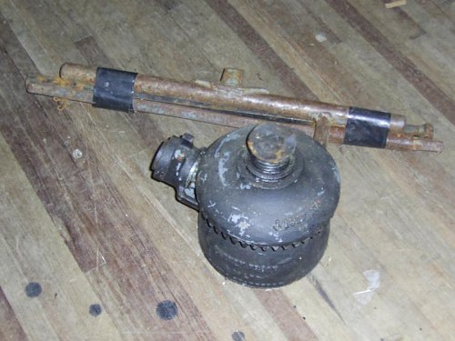

Could someone kindly post a picture (and make) of the type of jack I need to look for, for my MK2 Canadian. Or the British version.
Cheers Ron

Hi Ron here are some pictures of a Canadian one, courtesy of a Canadian forum member.
I don't know what the British carriers came with.

Thanks Lynn but I have one of those. It's the bottle jack I was referring to.
Ron

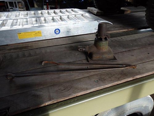

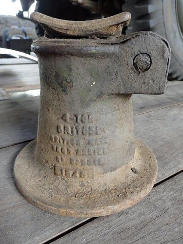

Hi Ron, This is the Jack used on British MkI carriers (mechanical screw type)
They used the bracket which was made to suit them. The Canadian jacking block evolved to fit their adopted hydraulic jack into the original mechanical jack bracket. That is how I see the evolution of it anyhow.
These are (were) made by various manufacturers. This one is Ern Lake. I also have a Britool one. Some are steel bodied, this one is alloy with a chequer plate base. They are variously dated
They are rated at 4 ton and 4 1/2 ton. there is an extension that clips on the top (I need one)
They come with a handle, and a two piece extension (fairly crude) I believe the early carriers had a longer single piece extension (which made it shorter than the two piece if you follow)
They lift higher than you might first think, and yes, it could be the same as the 4 tonner? (truck?)
There are different shaped ones as well.

I've finally acquired an Ern Lake jack for my carrier. I assume it should be painted green? Although I see that Lilibets jack is red.
Also I'm missing the wooden operating handle if anyone has one to sell.
Ron

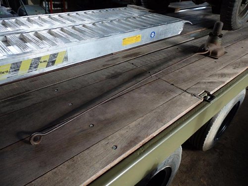

OK! Help required with handle...Lynn? The handle that came with this jack has no square on the business end and a number on the wooden shaft end. Any ideas please, or pictures of the correct part. Ron
Old 21-08-14, 01:25
Ron, Sorry, I don't know. I believe there was a one piece extension for the early Brens, but by the time of Bren No2 MkI, they had gone over to a two piece extension.
I will have to hunt for pictures of the two piece and handle (all steel) if anyone else wants to jump in with photos, go for it. The stowage on the carriers stayed the same for quite a while, with the steel box pockets on the Canadian Universal Mk1* staying with the same configuration (even though they moved under the battery box)

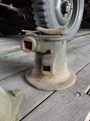

There are two types of 4 ton jacks that fit that (British) pattern. The first and it seems the more common is the type you have got. On a carrier I believe the handle is in three pieces and this comes apart and is stored in the boxes on the rear deck, there's a strap for stopping them coming out. There's also a cap that fits on the top section, I've attached a picture of what I believe to be a complete carrier set up.
There is a second type that has the same base dimensions, operating procedure etc but is an entirely different shape. This type has a folding top rather than one that slides off. My one shown below is 1/43 dated and has a slightly different handle fixing, I'm not sure about this specific handle set up.
I have seen period pictures of both types stowed on carriers, the second one seems to be the standard type seen stowed on the wing in period photos of Dingos (the manual shows another type!!) the Chilwell carrier workshop manual shows the second type used whilst explaining how to jack and remove the suspension on a carrier.
Yours looks like a good find, you need to look out for a handle and top to complete it for the carrier. Mine is not dated but I've seen them dated into the 60's
Hope that helps
Ben

Thanks Ben. That is exactly the information/picture I need. I'm now looking for that thee part handle.....Or more likely have to get them made. Ron

Ron, Mine is exactly as per Ben's first picture.
If you happen to find a one piece extension (it will be shorter than the over all length of the two piece) I'm interested.

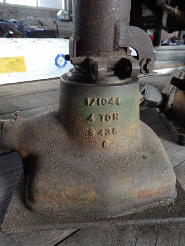

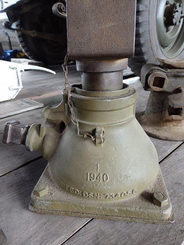

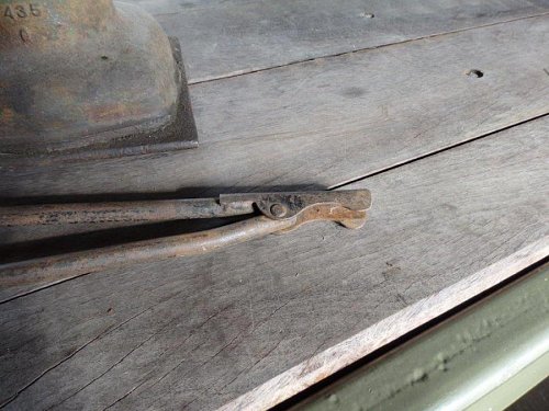

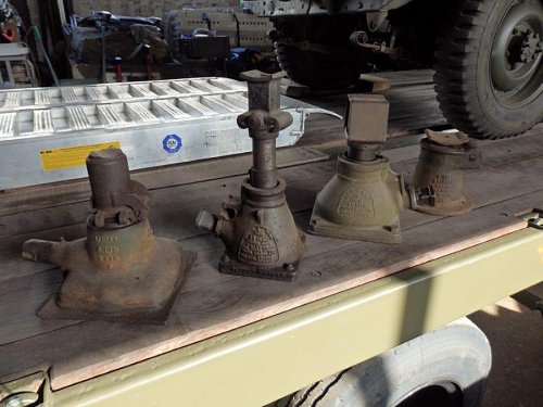

Hi Ron,
Here some of the jacks I have accumulated over the years for my vehicles and collection.
Ferret with wheel brace. This brace/handle does indeed look the same as the Brit Carrier set.
Name:	Ferret jack+handle.jpg
From left: Daimler Dingo & Armoured Car. One unknown. Brit Carrier. One other unknown.
Dingo/DAC but with handle.
ID:	67299 Click image for larger version
ID:	67300 Click image for larger version
I have the handle on loan to copy as none of the three Dingo/DAC jacks I have came with the handle.
@Ben. I would love to see a scan of the Dingo jack in your manual. I have quite a few of the manuals and a parts lists for Daimler but don't remember ever seeing a jack pictured? Thanks.
If anybody has an idea what the two unknown jacks are for/off I would be happy to hear it. Thanks! More photos in next post.

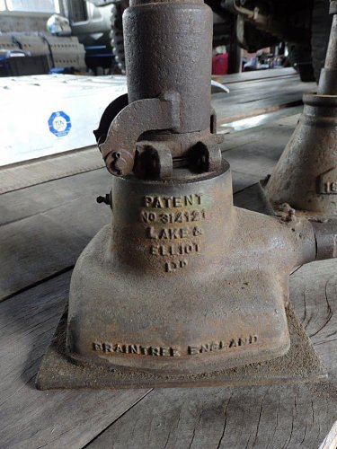

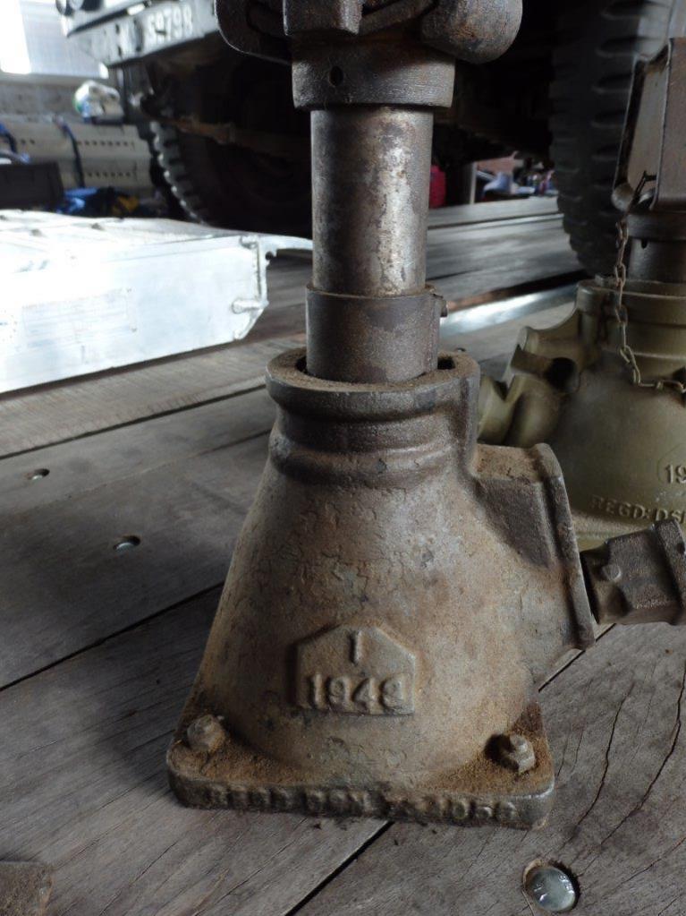

Old 22-08-14, 22:02
Marc van Aalderen's Avatar
Join Date: May 2009
Posts: 481
ID:	67306 Click image for larger version
ID:	67307 Click image for larger version
ID:	67308 Click image for larger version
Marc van Aalderen
Daimler Dingo Mk1B 1941
Daimler Armoured Car Mk1 1943
Daimler Ferret Mk1/1 1959
Austin Tilly 1943
Austin K6A Breakdown 1944
Daf Trailer AT16-24-1NL 1977
Daf 2100Turbo 1982

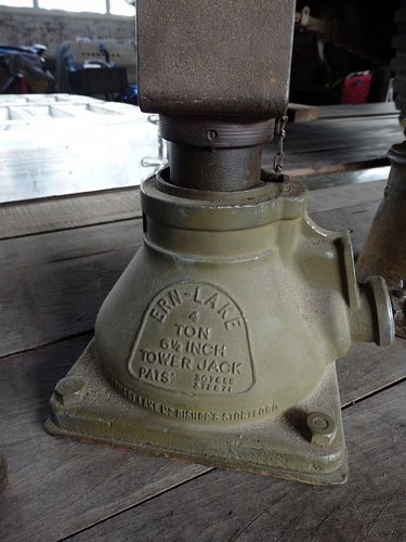

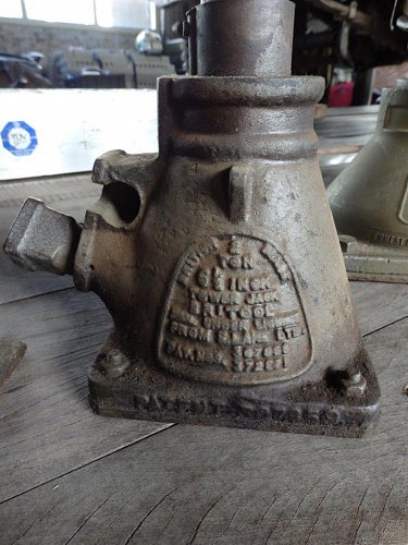

Old 22-08-14, 22:04
Join Date: May 2009
Posts: 481
And from the other side.
ID:	67310 Click image for larger version
ID:	67311 Click image for larger version
ID:	67312 Click image for larger version

Marc, thanks for posting. I see the small square based one is rated at 2 ton.
This has me wondering what it might be from. The things that come to mind are; Loyd, Tankette, D/dingo. What jacks go with those vehicles? for the higher rated ones What came with the various Vickers-Carden-Loyd light tanks of the different marks?
There must have been some "cross use". The various extensions indicate adaption.
