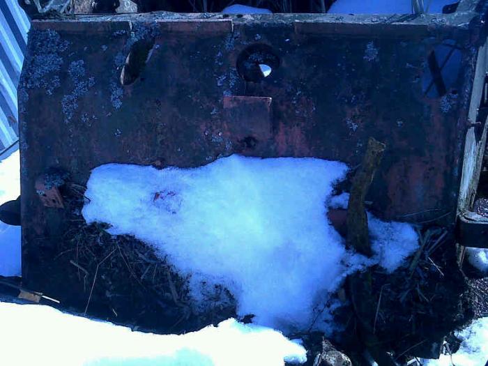

Good golly Wayne. What are all those holes? They look very recent. Have you been trying something out?
Hell no! I'm not that old!

Hi David, this is one of the Firing Range Wrecks I recovered a while ago. It got a quick paint job for use as a backdrop for a photo shoot.
It copped a fair bit of stick from CG 84s and small arms fire for 40 years.
Here is the down range side and the reason it is getting chopped.
Wayne

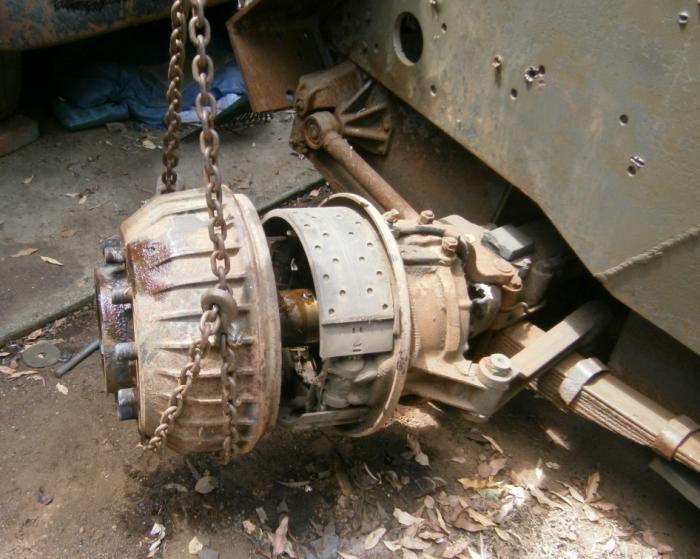

Pulled apart the only hub that doesn't have damage. Came apart easy enough and the design is very "Chev".
The hub and brake shoes have very little wear.
Wayne

Am I seeing things or is there a notch in the axle tube adjacent the inner bearing location? It's an optical delusion right?

David, That is a grease return hole on the top of the bearing mount.
