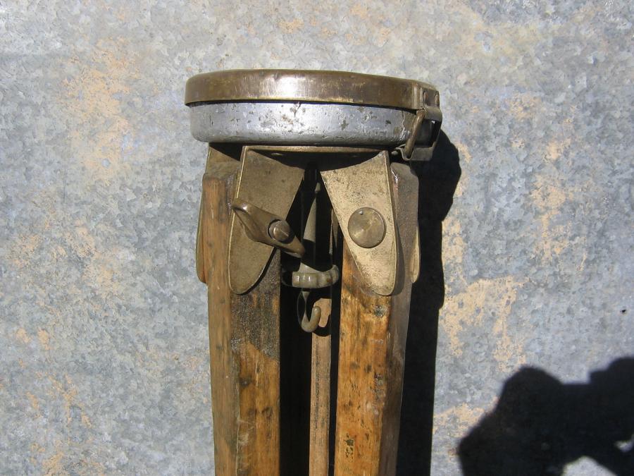

I bid on this scope and tripod cause I wanted the tripod. It went nuts and sold for $512. The shiny objects syndrome must have kicked in I guess. I figured maybe $150.
Would this No 12 Mk VII Rangefinder be what they used early in the war? The little tripod looks like it would be the right one for it.

In this part of the world, I've seen range finders made by Barr & Stroud .
http://www.google.com.au/url?q=http:...qSPlFQ7Ofbbizg
This u tube video may help
http://www.google.com.au/url?q=http:...ZVqZOsfK3vbbqg
