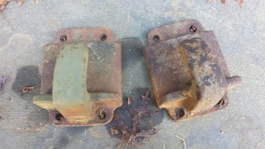

Not much to update with the carrier, as there hasn't been much opportunity recently with work getting in the way....
Anyway, I wanted to post some pics of a recent barn find, while picking on a farm looking for BGC parts and other bits n pieces. They appear to be grenade boxes, and look like they were painted white originally, with the stencil applied to the front, and felt attached to the inside of the lid. The stencil reads: "GRENADE - SMOKE & THERMITE"
What I don't know is from which vehicle they may have come from, and secondly if anyone out there might have a need or use for them in their restoration project? Given that they were painted white, I'm guessing that they originally came from a US produced armoured vehicle, as british vehicles were painted silver internally. Anyway, enjoy the attached pics.
If anyone can shed any light as to their origin and use, or if they are useful for a restoration project, please let me know.
I agree with them coming from a US produced armoured vehicle; my guess is M3 Medium Tank or M3 Light Tank.

If those air-tubes are of no use to you, please put my name on them as I need them for 2250.(fingers crossed)

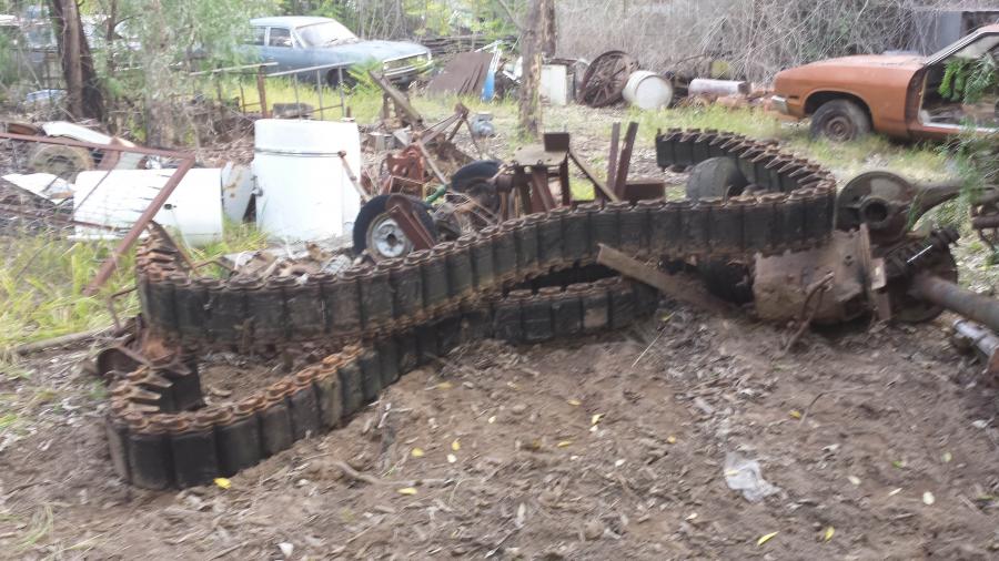

While out picking in the area recently, I have also made some interesting finds. I believe that tracks and ammo storage bins are from a M3 Grant/Lee, and some interesting looking tow points from a ???? If anyone can help ID, or if your interested in the M3 Grant/Lee parts please let me know. Enjoy the pics.

Excellent work Matt, it always feels good to see progress. Looking at the track and the ammo holders there, I would assume that they are off a grant. Do you happen to know the dia of the ammo holes by chance.

No I don't know the diameter but fortunately the ammo racks aren't too far from home, so I should be able to get your answer soon.
