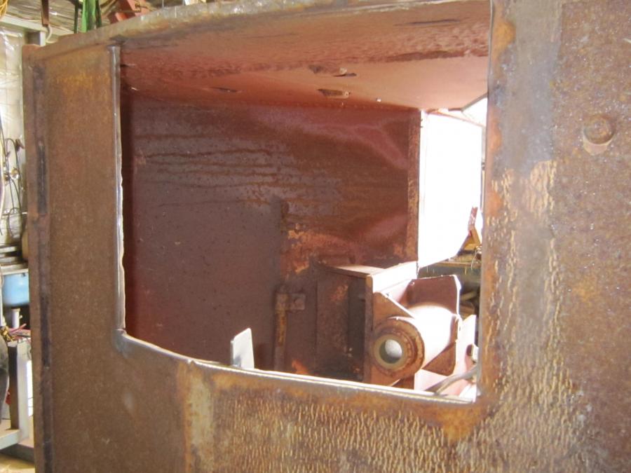

Most of the mounting blocks werepretty ordinary so I decided to remove all of them from the floor and replace with nice newies and also put some new sleel in the hole in the floor.

The piece is all welded in place and just waiting for the grinder. The firewall was all but gone at the bottom which is very common for these machines that have been left outside all those years but it's no good looking at it as they just don't repair themselves. (unfortunately)

All done and that's a bit of a hassle to do. Having the hull on it's side does make it easier though. I also had to machine up the steering pivot bracket as it also had the same fate as the mounting blocks.

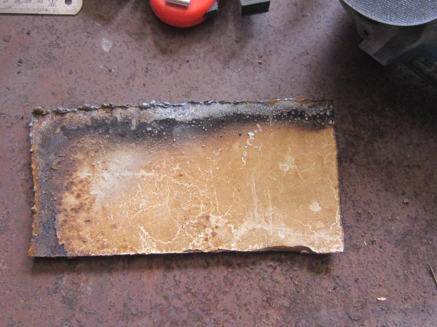

My L/H engine support plate is also nearly gone but I had a piece of another one so I am reconstructing the rest of it. It is also quite pitted on the top so I'll fix that too.

Some of the pitting went over half way so I welded, ground, welded, ground, welded and ground until I got a reasonable flat surface. I'll finish that part tomorrow!

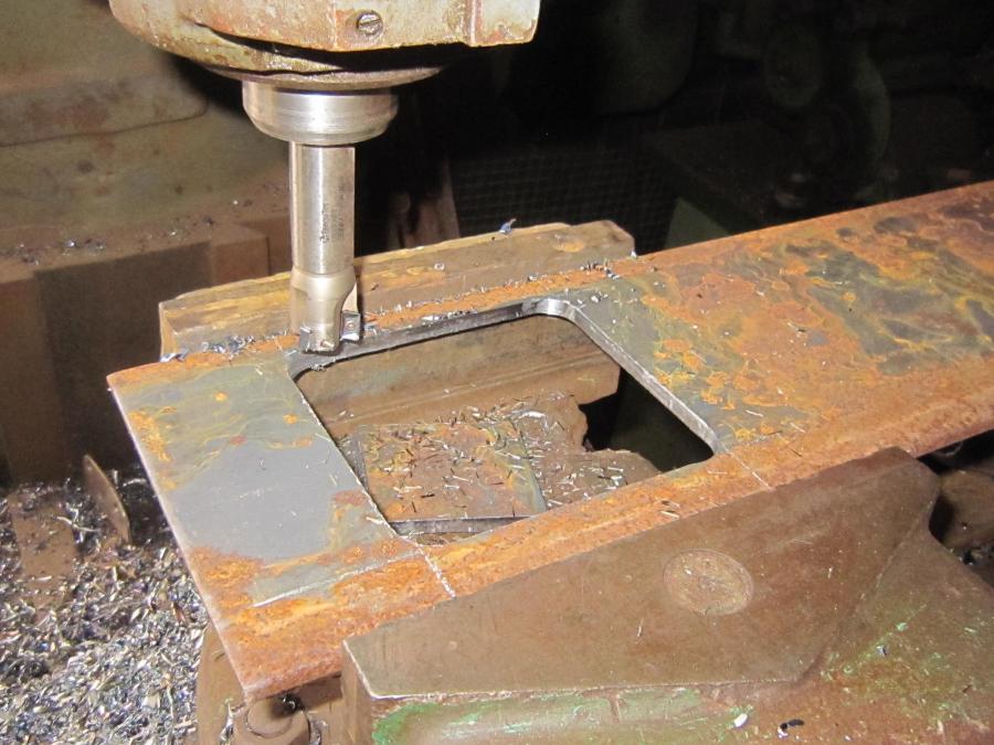

I found some 40mm thick plate and welded a locating piece of steel in the centre and used for the chuck to hold on to. I machined it to the shape I wanted and that is my top part of the press tool. the bottom part was obviously a female part. I just roughly put them in the press with some 1.2 steel that I cut in a bit of a circle and to my surprise it actually did a neat compound pressing and to the size I need so now I can go ahead and make the mufflers.
