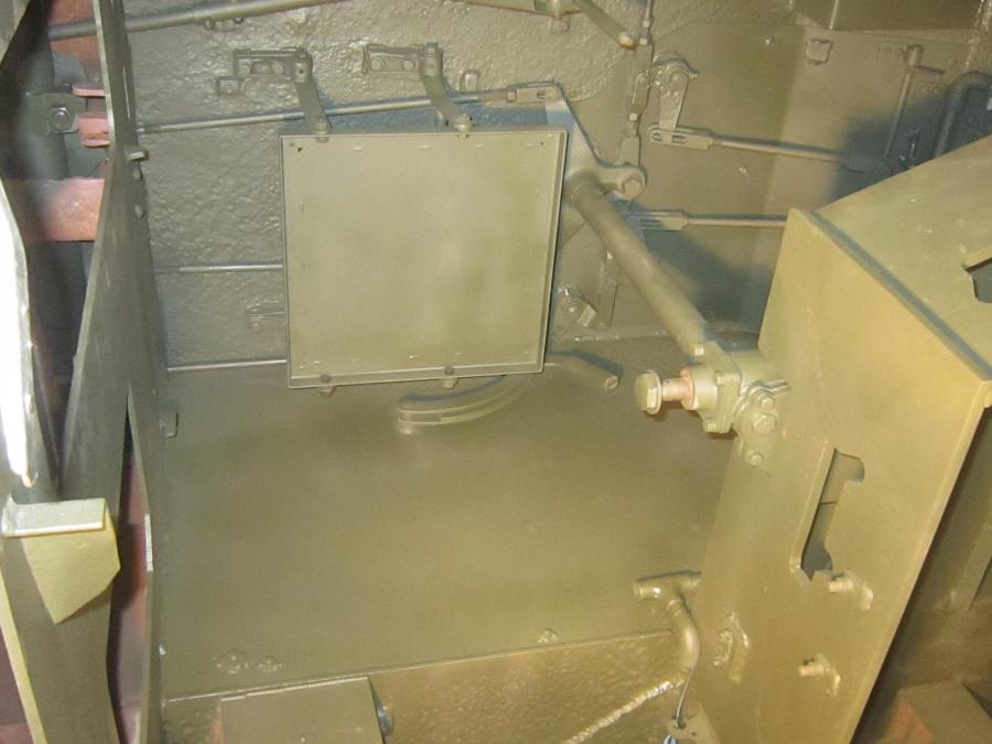

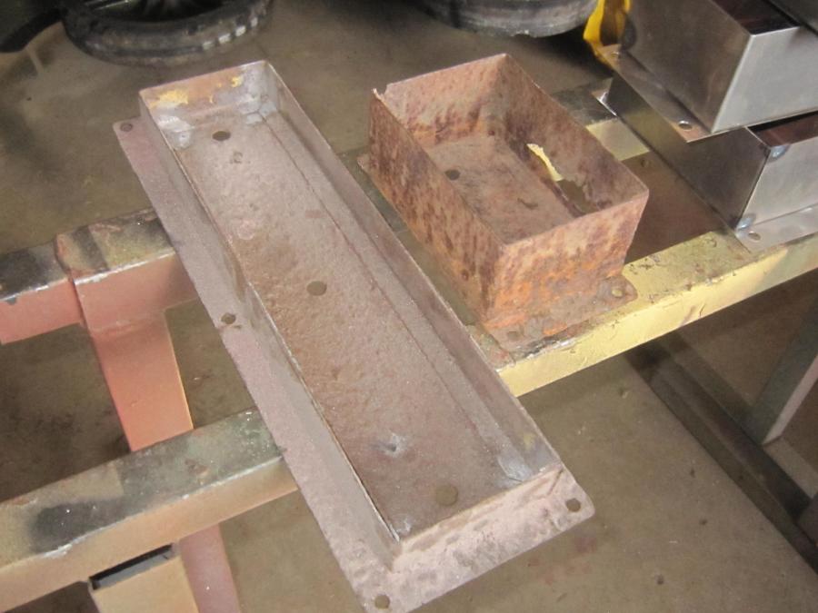

I have done my floor plate and have made some of the Vickers ammo and parts floor holders.

I would assume that these would also be in the NZ carriers as well.

Old 23-04-15, 15:51
Euan McDonald's Avatar
V.M.V.C Member
Posts: 627
Default SA rail
The vicker's box mount in a SA carrier are the same but very different .
