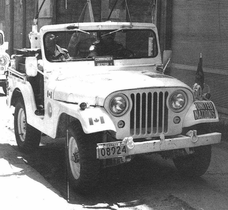

Expanding on one of the photos Rob Love posted earlier, here is a pair of UN Cdn jeeps in service in Cyprus and neither of them is MG equipped. Plates on the vehicles front to rear are: 08924 and 08929. Photo is from "MUSKETS TO MISSILES".
Interesting that all three M38A1s in UN colours shown in this thread are late CFR Cdn3s. They are 08912, 08924 and 08929.
CFRs 08919 and 09049 also were UN jeeps according to photos posted over on Clive's Ramtank.ca site. http://ramtank.ca/m38a1list5.htm
Note the Cdn 3 CFRs ended at 09095.
