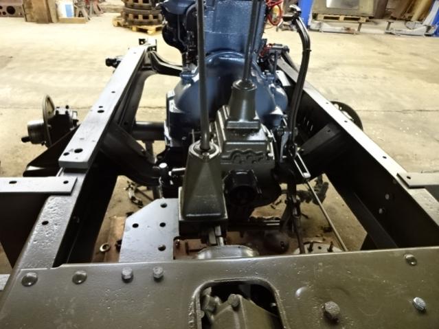

Posts: 16
Well ive been cracking on since the last post, the engine is now in the chassis, various oil seals have been fitted. The front axles are back together. I have also got the master cylinder fitted and new copper brake pipes made and fitted. Ive also fitted the brake cylinders, along with new flexis. Ive also got the floor fitted and the battery box.I have also got the new hardwood pieces for the seat runners to bolt through. heres a few pics.
chevrolet c60s 003.jpg   chevrolet c60s 011.jpg   chevrolet c60s 006.jpg   chevrolet c60s 007.jpg   chevrolet c60s 008.jpg
