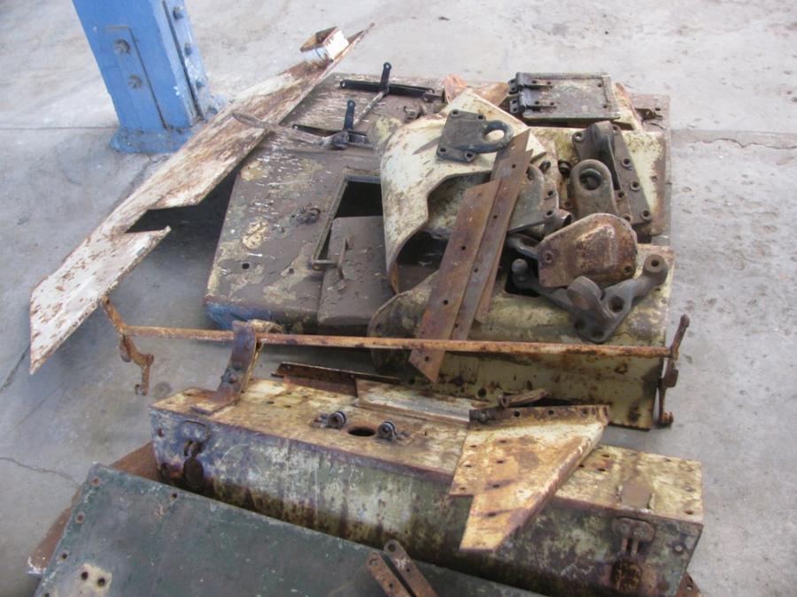

  #66
Old 29-06-15, 13:37
lynx42 lynx42 is online now
The reason it hinges in the middle is so the front half can be folded back or with it in that position the whole roof lifts back and sits on a special rack at the rear of the crew compartment. Rubber head protectors were where the darker parts are. These pads were about 1/2 inch thick but very necessary when closed down.
Plenty of rust to beat here.

The marker lights were badly rusted and needed replacing.
The rusted right marker light.
