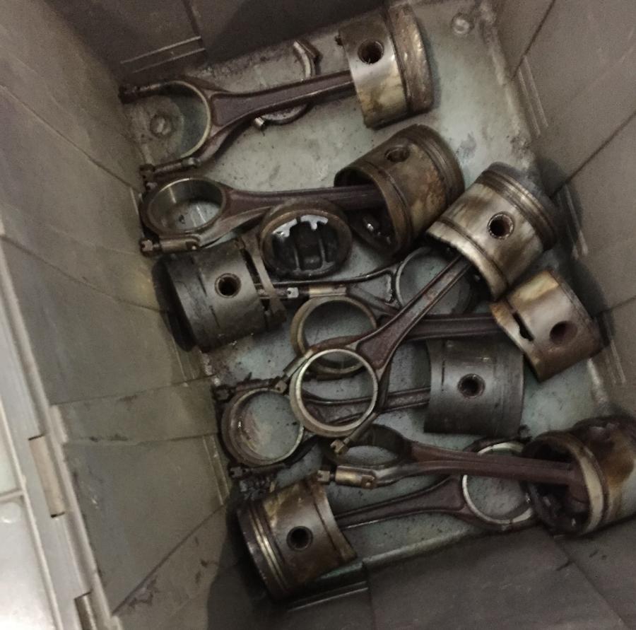

The results of the magnaflux have provided enough information to determine that the engine can be rebuilt. That's the good news. However the pitting on the cylinder walls was extensive enough that the cylinders will have to be sleeved. There was one small crack found, but the folks at the engine shop claim that it can be "pinned". They have a fair bit of experience with the 239 and appear to be quite confident.
It will be great if the Lynx can be restored with the original major components. I do have another 239 lurking around in the recesses of the garage, but I believe it to be post WW 11, and if anything it's in worse shape.
Peter

Old 08-08-15, 05:41
Peter, how bad is the pitting? Will it bore to 3+5/16"? They will (apparently)go out past that and pistons (and gaskets to suit) are readily available. They can go out safely as far as 3+7/16" in a really good block. (not suggesting you risk that) 3+5/16 is considered safe enough to not have to do anything special as far as a porous bore goes, if your block is not badly rusted in the water jacket.
It will give you more cubes.
The extra cost of sleeving can be diverted to the pistons.
Be aware that there is always a degree of risk in going for the o/s bore.

Old 08-08-15, 08:24
Join Date: Aug 2012
Posts: 567
Default Oversize
Lynn , I think the blocks that suit the 3 5/16 are the C59 blocks, (later model )that the hot rodder's love to bore out because these blocks are apparently thicker in the wall. I do not think the 99A's will go that far.
Valentine MkV
Covenanter MkIV
Lynx MKI and MKII
M3 Stuart
  #205
Old 08-08-15, 14:49
I may well be wrong, but my understanding is that any of the blocks that were made with 3+3/16" bore, will work. The 3+1/16" blocks can only go out to 3+3/16"
If I have this wrong please someone let me know.
If you think about it
Std bore =3.1875
+.060" over bore (normal)= 3.2475 (2 1/2 thou under 3 1/4")
Add to that another ).0625" (1/16th")(or another 0.031 thou from each side) and you are there.
