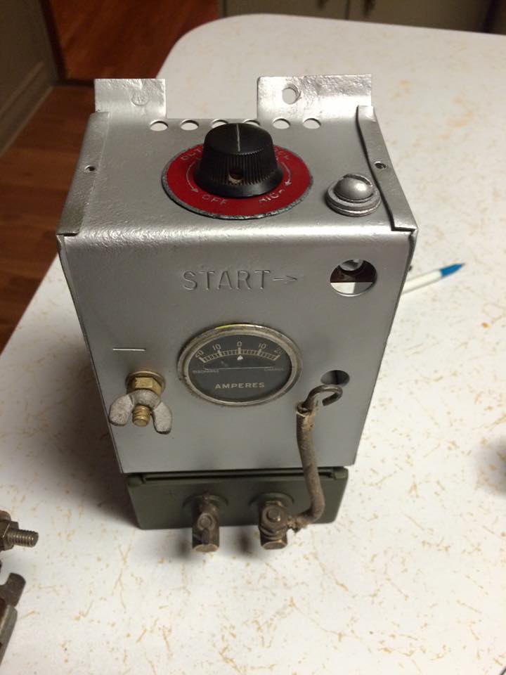

Currently working on restoring a chorehorse generator I recently picked up. Does anyone know what the proper colour was on the small round charging plate? I've seen examples with the plate being red and others being black. This is the plate mounded beneath the charging rate knob.
I'll post pictures of my restoration efforts later tonight.

Mine was red, made by Outboard Marine & Manufacturing.
Old 30-10-15, 02:38
Posts: 4,192
Thanks Bruce.

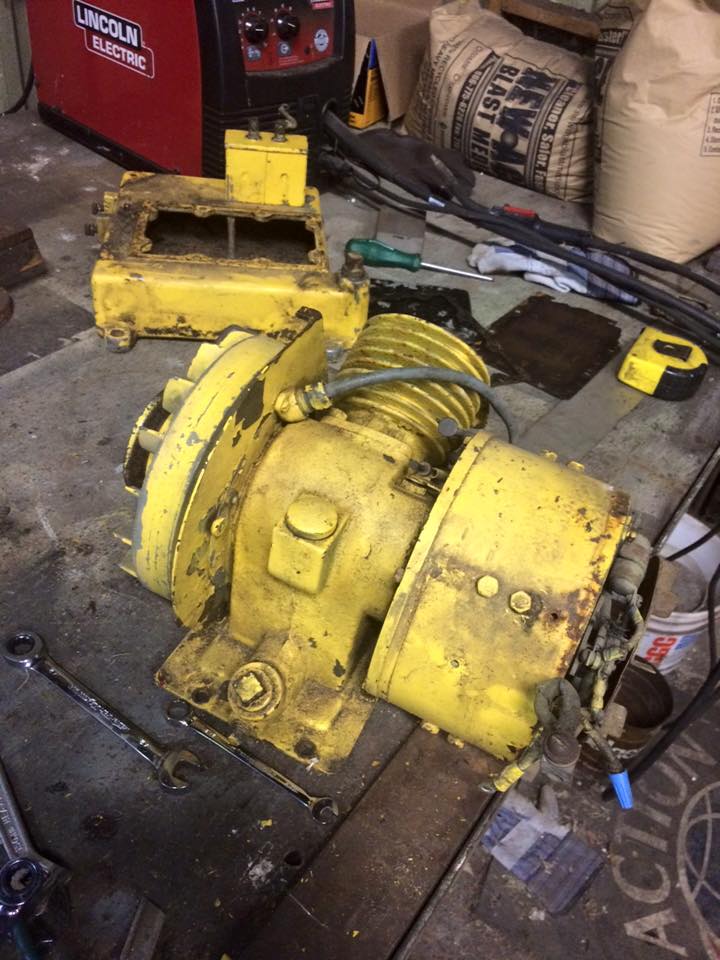

On futher inspection I found traces of red inside some of the small letters.
I also found a nice C Broad Arrow stamped into the generator housing. It was under a few layers of paint.
As for the restoration I stripped the unit down into individual pieces and sub assemblies. Ran most of them through the sandblasting cabinet and then used a rattle can of green to paint it. I do need to replace the spark plug cable. But that will come another day.
Old 30-10-15, 02:39
Posts: 4,192
Things are coming together. Thankfully no bits were left over.

Jordan, any idea what the colour was on the square face where the ammeter gauge and side panels are? One of mine that is peeling post-war paint to show brown underneath would indicate these parts were grey, similar to a 19 set face.
Old 31-10-15, 02:12
BCA BCA is offline
Brian Asbury
Join Date: Oct 2006
Location: Ontario, Canada
Posts: 658
Both the WW2 CHI-395 and the post-war conversion PU-5008 have silver-coloured control panels (front and sides) as well as silver-coloured rope pullies. I think aluminum spray paint is close. Perhaps someone has figured out the circuit changes that were done to convert the 15 volt WW2 units to the 30 volt post-war units. ............ Brian

Went back and have begun repainting the control box. I also refinished the output control tag. There wasn't much depth left to the plate so scrapping the red paint off wouldn't work. I used white glue painted onto the letters as a paint mask. Once painted I simply scratched and peeled off the glue. Worked alright.
One thing with my generator was that there was an additional toggle switch wired in. On further inspection it has been added to replace the push button starter switch. Hopefully the cutout relay is still good.
