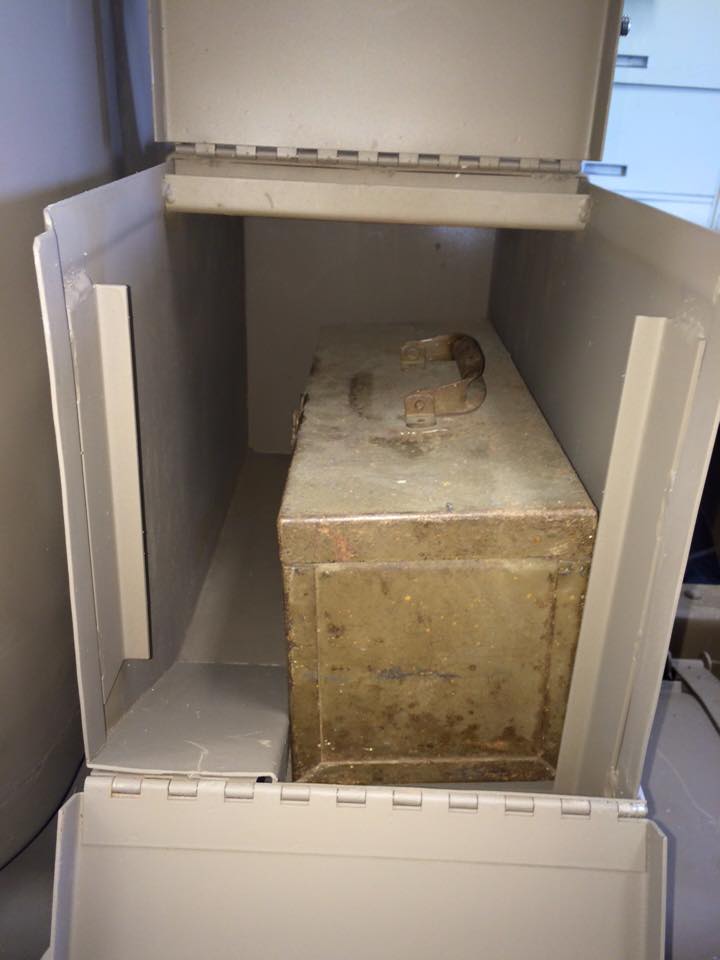

Finished the work on the spare tire carrier and tool box yesterday. This box is a copy that was made a number of years ago. I had to go back an do some minor work on a couple of details to make it closer to the originals. The pivot brackets for the clam shells and the hasp for the locks needed to be rebuilt. Lastly the clam shell retainers were made as the one original I had was rusted out.
Great job Jordan! Would you be so kind to post the dimensions of the pivot brackets for the clam shells? These were rusted out on mine, so I need to re manufacture them.
Thanks in advance!

Posts: 4,189
Sure Hanno. Ive got the rusted right and left originals still at home.

Posts: 4,189
Figured out the hole issue for mounting the tool box today. Drilled the holes and eveything lined up really well. I did a final fitting and then pulled it all off to repaint the bottom and do some touch ups. I even tried out fitting the tool box into the tool box.
