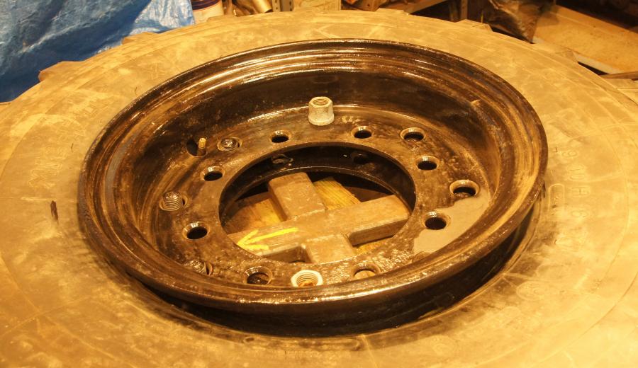

Pic 6 Two crosses where fabricated...... the bottom one will fit underside fo the lower half of the CMP wheel
Pic 7 the top cross is 18 3/4 in. the btoom one 14 inches. Holes are drilled to match the bolt circle of the CMP wheel pattern. Holes are best drilled at 7/8 for some looseness.
Pic 8 Notice the yellow arrow...... holes seem to line up better in this configuration. Nuts have been welded on the bottom of the smaller cross.
Pic 9 The top cross is meant to fit loosely on top of the bottom half of the CMP rim.
Pic 10 You can see the space between rim and puch blocks. Blocks were made of cut off piece 2x2 and welded.
NOTE.... if Imade another one I would reduce the space between rim and cross puch bocks to about 1/8 of an inch.
When that cross with the blocks if fulled screw in the tire bead willbe at least 2 inches or about mid way on the bottom half of the rim.

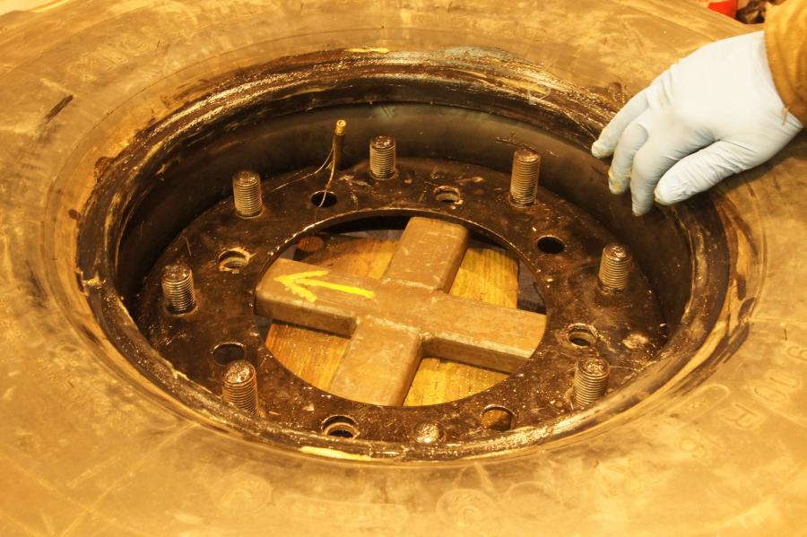

Pic 12 Shows the bottom of the rim with the cross sitting inside.... roughly lined up with the wheel holes.
Pic 13 Flipped over the cross is now resting on a scrap piece of wood roughly 7x7 square... it keeps the bottom cross held against the rim and makes it easier to start the bolts.....
Pic 14 shows the upper cross overlapping the rim's edge.

Pic 17- Tire is just barely balanced on the bottom half of the rim. Actually had a tendency to iether slip on one side or the other.
Pic 18 Looking at the isnde of this dry mount....... the side further form the camera was slightly lower than the front side..... that is where the tool comes handy in leveling this difference.
Pic 19 We have installed the top cross inside the rim....... a little tricky as the side walls were stiff and the push block had to be squeezed in. Two bolts are installed for this dry installation/illustration.
Pic 20 & 21 shows how the push blocks are resting on the bead. Not even at this stage but when we do the actual installation the high side would be srewed down first then alternate to keep the cross even.

Posts: 2,323
I have decided that my difficulty mounting the Michelin LTX tires on CMP rims was largely due to more flexible sidewall and bead structure. After a couple of false starts I added an auxiliary pusher made from short bits of 2x3 and 2x4 lumber powered by a C clamp to push the bead around the curve of the rim. Once round the curve, the cross pusher worked fine to take the tire further down the rim ready for the tube and flap. The other half of the rim went on exactly as expected, Put the rim in place, tighten the rim halves together and add air to ease the tire into place on the rim. Photos attached show the wood addition to tooling, the tire half mounted and the finished product.
Also comparative photos showing the LT235/85R16E LTX against the STA chevron tires in 10.50-16 size and against Michelin XL in 9.00-16. Although the LTX look small in comparison, they are rated to carry over 3000 pounds which is actually slightly greater than the rating of the 9.00-16 CMP tires (although they were run over capacity for some of the 15cwt trucks).
wood push block.jpg   LTX half installed.jpg   LTX installed.jpg   LTX vs STA chevron.jpg   LTX vs XL.jpg

Well at risk of repeating what may have already been said...in my experience the biggest pain was getting the 60 year old tires off the rims. I used a backhoe; put the stabilizer leg down on one side of the tire and pushed down the tire with the bucket and then cut the bead with a torch. Once practiced it was easy to do. To put the new US style tires on I had the rims turned down about 1/16 inch all the way around the inside. This removed most of the pitting, left a smooth surface so a minimum of "SNOTH" was required and hopefully made it easier to remove them again some day. I will be trying this method again this summer but will have the rims sandblasted once I get the old tires off...BP
