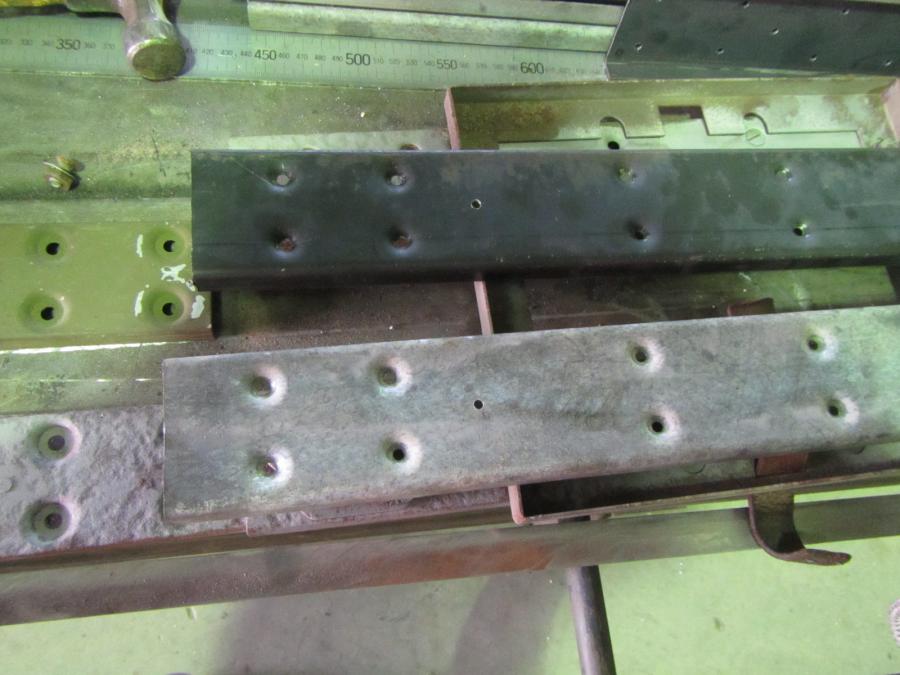

Morning and Happy New Year to everyone.
I'm attempting to make some No11- 19 Radio mounts which have quite a few pressings and hole recesses but! I just started with a couple of 16mm thick plates and squared them up to the same size which just makes them easy to line up. Marked exactly where the side pressings are and milled out the unwanted material to a depth of 3mm then repeated the opposite side with a match.

I gave both pieces a clean up with a flap disc in my 5" grinder and file then did a test piece and it did turn out really nice. I just need to cut my pieces to shape and nd then make some more parts possibly today.
Colin.
