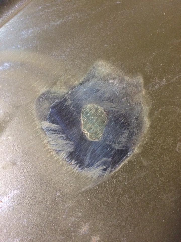

I have finally finished all of the body work repairs. I ended up cutting out the old brazed repairs and welding in new sheet metal. For the brazed over holes I found it easiest to simply use a punch and hammer and knock them out. Next will be getting the frame and body panels all sandblasted. One thing I noticed is that one of my side panels is a thinner gauge sheet then the other.
