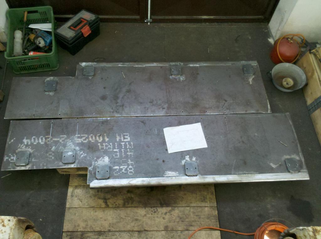

Finally did some work on the hull. Remains of the side armour have been cut and cleaned. Still plenty of work there but happy with the start

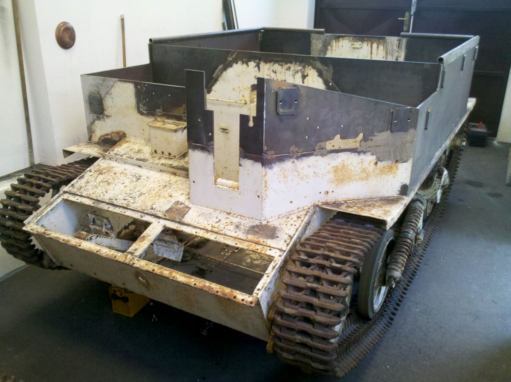

Hull almost ready for new plates.

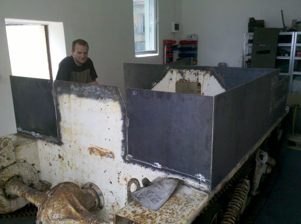

Finally got some time to continue on the hull. Few plates stitched today, more will come tomorrow
She is getting slowly in the shape, isnt she?

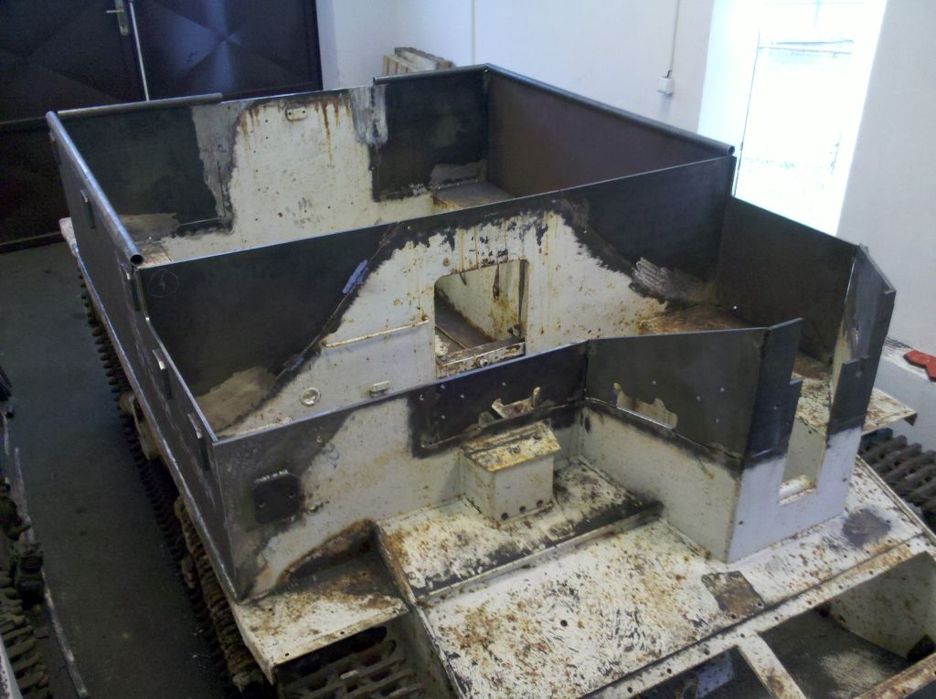

Today's task archieved. With the help from my friend and big hammer

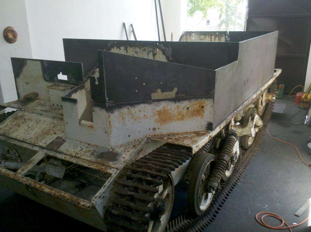

Few more pieces fitted...
