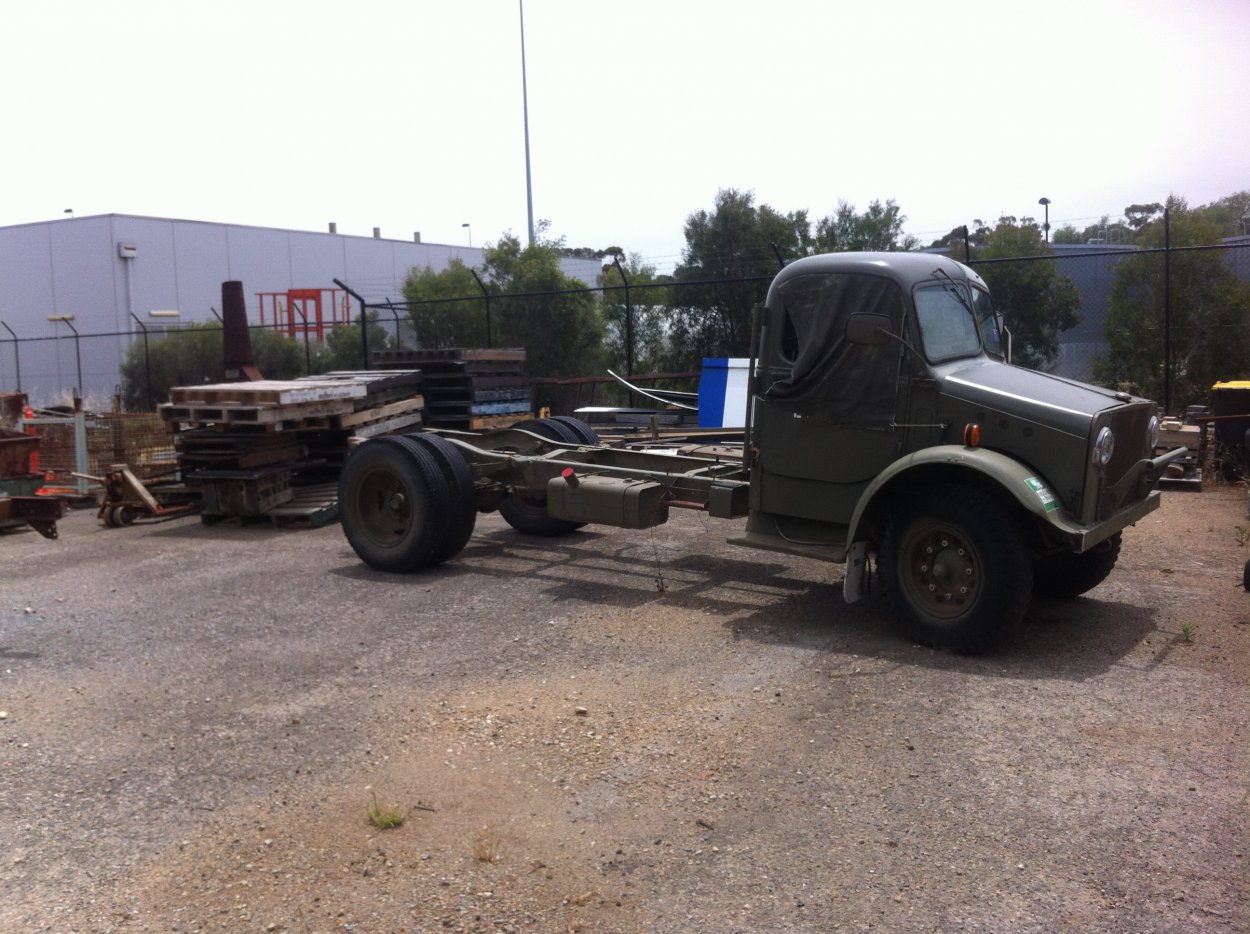

Hi Sorry for not posting photos,, now that I think what I am doing I'll try some general photos of the truck.

Hi Matt,
I think you will find that roof hatch, or cupola was not added until late 1943. Does it have sling plates on the wheel hubs? The engine number that Rick C quoted sounds like a 43/44 build, also noted it appears to be painted black, in the event that it had never been overhauled this could be the original factory finish.
Now I know how to load a photo here's the hub.
Old 30-05-16, 11:59
mlombard mlombard is offline
Join Date: May 2016
Location: Australia
Posts: 62
Hi Matt,
Not quite as cut and dried as all that. There would be very few OY Bedfords around with the civilian type wheels with twins on rear. Most were lost in France and Dunkirk in 1940. The bellows air cleaner could be found on later OY's. The year of your chassis number, assuming 73076 is correct would be 1943 as production that year was chassis numbers 68618 to 79852 (according to Bart V and he was a stickler for accuracy of facts). The cab cupola was introduced at chassis no. 78696 and another feature worth checking is to see if the top half of the cab was removable, as this feature came in to production with Chassis no. 43522.
On the dashboard, if you have a large round lighting and ignition switch in between speedo and combined gauge, then that feature came in on ch. no. 43522 (1941), this carried through to end of production.
regards, Richard

Matt, I think that Richard had to raise the cab up an inch or two to fit the later Bedford engine in. You might need to check that if you are going to do a proper restoration. From memory, the bottom of the cab should be close to level with the bottom of the chassis member. Richard F. can confirm that for you.
Matt,
As Rick appears to have the engine that came with the vehicle when he got it, I assume another engine is now fitted. If it is not a 28hp, then is a later 216? If so then there would be no reason to raise the cab. A few photos of engine would be good to see what it is.
Does not look like cab is lifted as it would not fit against front wings and bonnet. Would have to look at another to compare rear cab mounting.
regards, Richard
