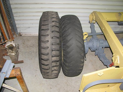

Tony, Not to sure you are right to say the carcass dimensions are identical. The Lynx 9:25 tyres are a low profile tyre and are many inches smaller in diameter than the 9:00 tyre. I have been told that the extra:25 is actually the width difference of the tread.
Here is a photo of my new 9:00x16 tyres next to a slightly worn 9:25x16 tyre off my Lynx. You can see the 9:00 is taller and also narrower than the 9:25 tyre.
Name:	Lynx Continues Tyres 024.JPG
The new 9:00x16 tyres did drop onto the Lynx rims very easily.
Regards Rick.
Old 06-07-16, 11:31
Regards Rick.
It's not equivalent to compare modern production tyres with wartime production. By far, the bulk of modern 9.00-16 tyres are made to different cross section shapes to WW2 tyres, and virtually all are of the "American" or 5 degree bead seat design.
I do have 2 WW2 Canadian 9.25 tyres and the carcass size is the same as Canadian and English 9.00-16 tyres I have. However, both 9.25s are from different manufacturers and while the tyre widths are the same, the tread widths are different
