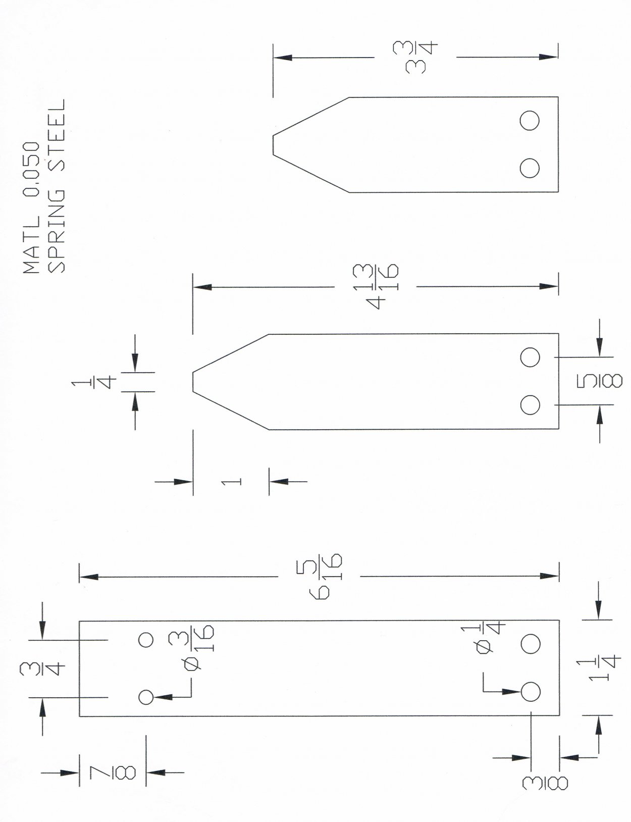

Here are drawings from my MkII* Canadian Carrier.
George

Thank you all for the information, most useful, I had a old wood saw
