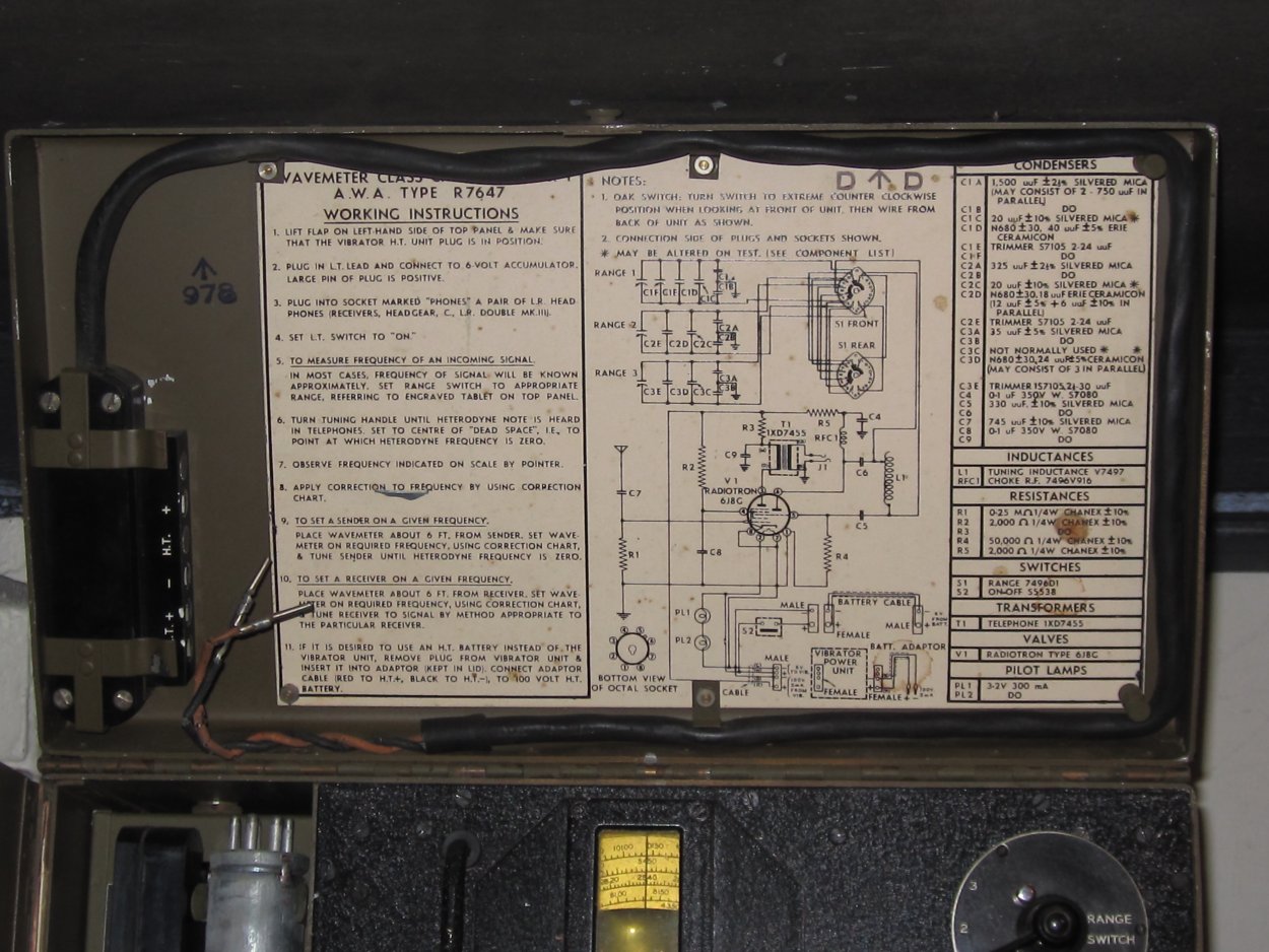

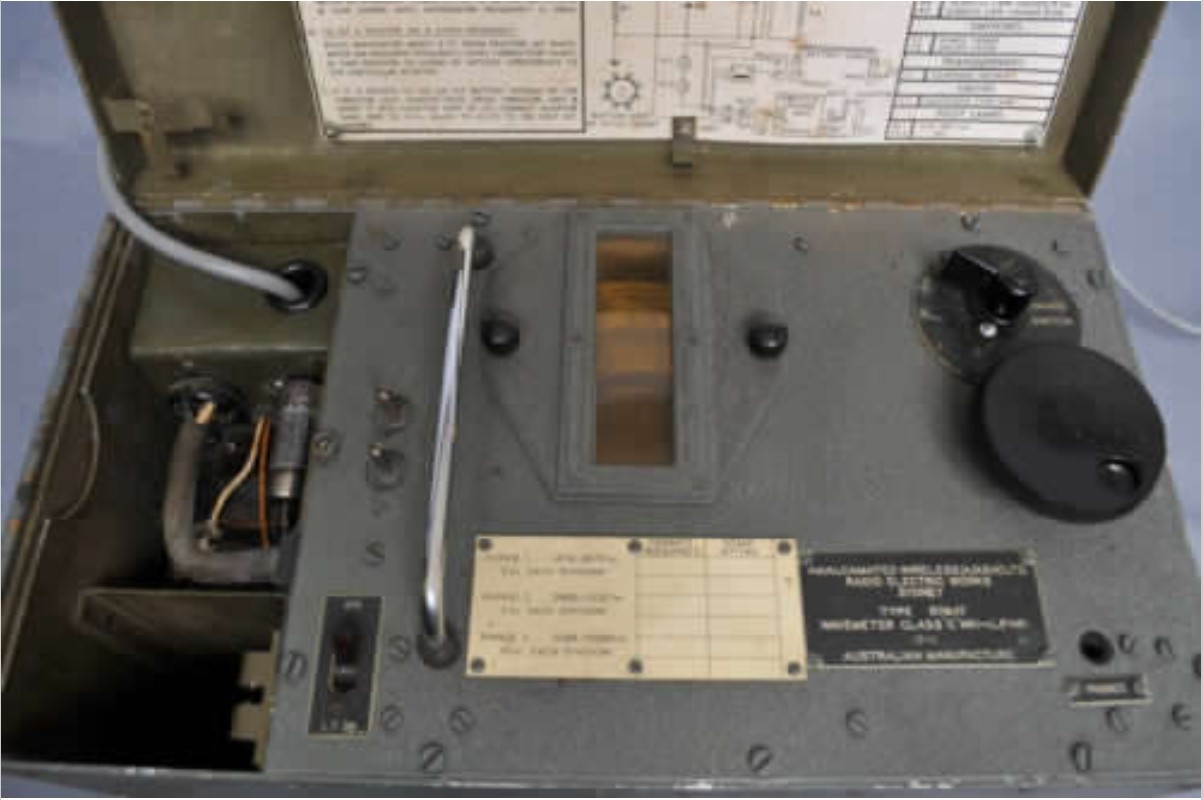

Hope I'm not muddying the waters here as my Wavemeter Class C is an Aussy one.
The adaptor appears to be the same as your English one requires?
The pin outs seem to be an original fitting but after 70 plus years there are no guarantees on that score.
Brent

No muddy waters! I have both an Aussie wavemaker and a Brit one. Those pins could be part of a Niphan plug.
Here's a guy on eBay that has some brass Niphan plugs that are pretty close to the wartime ones and they're a good price too. I bought a few from him and now I just have to find some of the other half.

Here's a wavemeter on Aussie ebay with a tatally different setup for the power supply.
