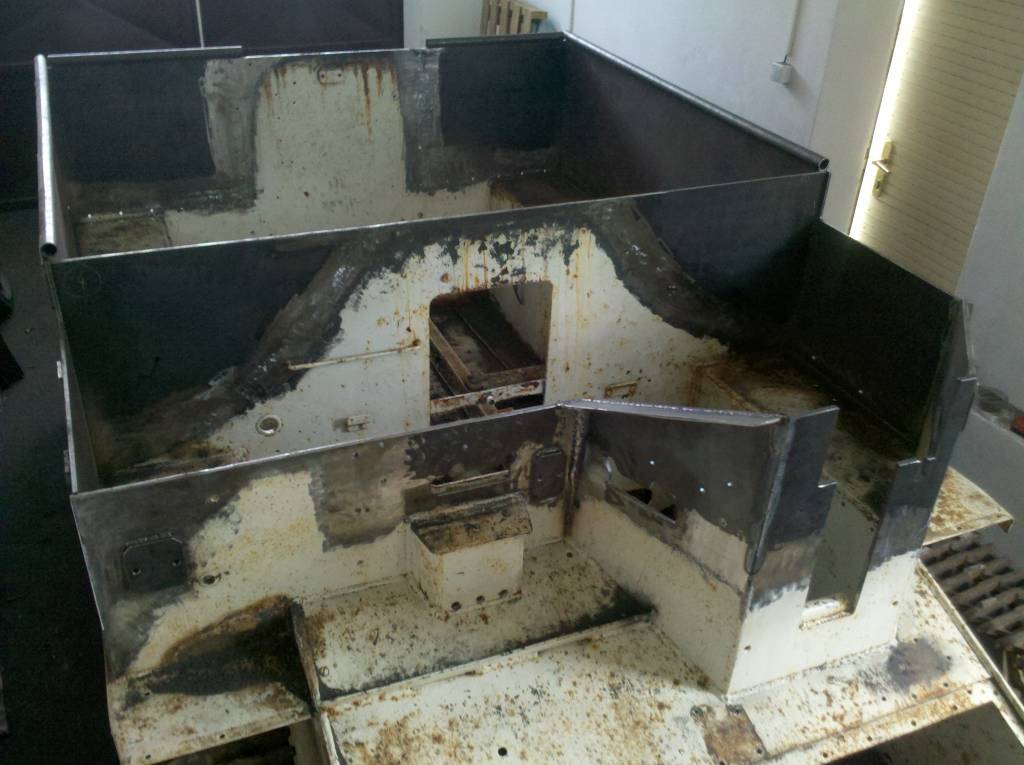

Old 28-08-16, 23:20
Join Date: Mar 2014
Location: Czech Republic
Posts: 549
After the holiday - back in the business
Welding of the hul finished, now must drill few more holes etc. and we will be ready for the sandblasting!

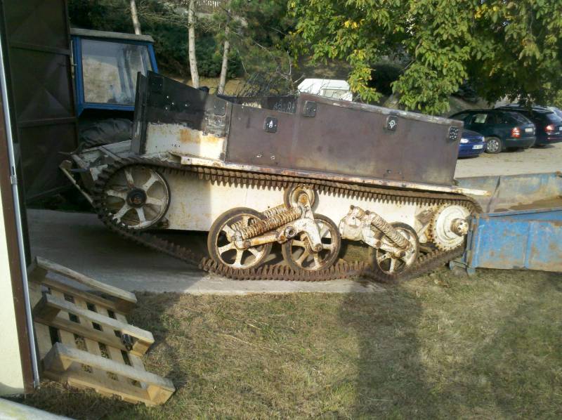

And unloading today morning
UCw Mk.III
  #176
Old 29-09-16, 18:14
Posts: 3,717
Not sure I like that chain placement, Petr. Hope everything worked out OK.
  #177
Old 29-09-16, 18:55
Join Date: Mar 2014
Posts: 549
Short chains, I know David. But its just empty hull, she can take it for once
UCw Mk.III

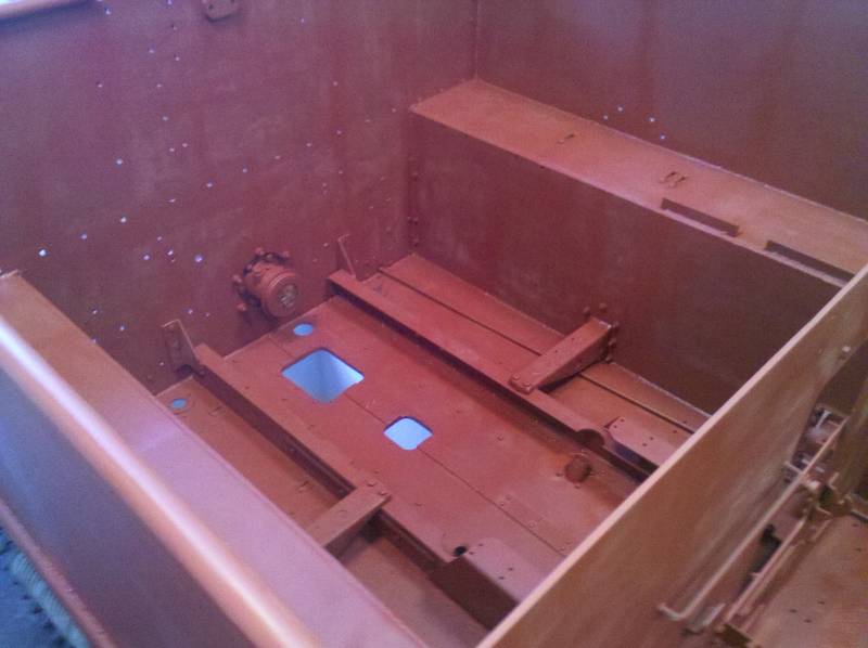

  #179
Old 01-10-16, 01:48
Looking great Petr! You photos reveal more about the MkIII U.C.
What is the purpose of the two big holes at the bottom of the Division plate?
I think I have a NOS door for the centre hole?
When you know what the notches in the right hand engine bed rail are for, please let me know.

Old 01-10-16, 22:11
Join Date: Mar 2014
Posts: 549
Hi Lynn, I have no idea what are these holes for. Maybe some wise guy on the forum can help us?
Primed today. 8 hours of dirty job.
