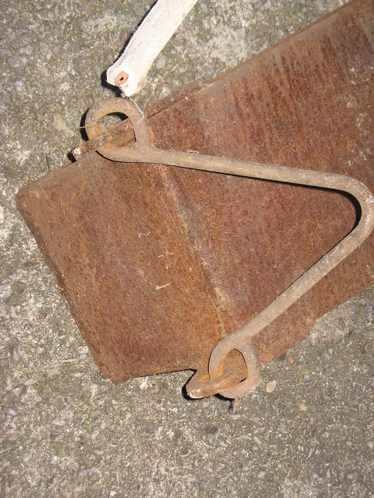

I finally got more photos downloaded for you. Looking at this set I don't think they would be very hard to duplicate.

Here are the rest of the photos. Notice where the chain attaches isn't as fancy as the riveted ones.

thank you! Yes, they seem to be later "low price & fast" type of production.
