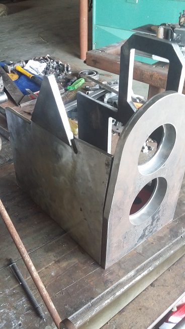

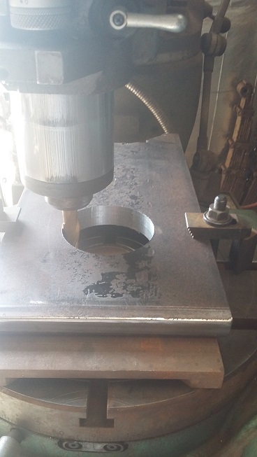

I have started with the end that bolts to the bell housing first. Because the bearings are 20mm thick, I have used a piece of 25mm thick plate so by the time I machine it down, I will have a bearing stop and also a wider top to allow for the studs to be screwed in. I am using my rotary table in the mill to achieve the bearing holes.

There is one thing I can guarantee. It's going to be a lot heavier than the original. I have machined all the excess steel away, so the general thickness is now 13mm.

I am quite happy with my progress to date. The more I do the more confident I am getting that the end result will be OK
