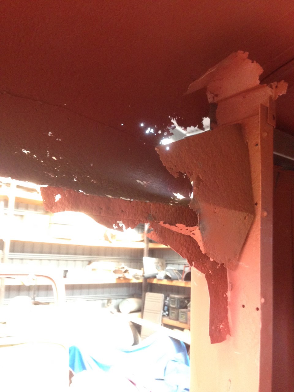

to rebuild the back corner i had to open up a rear box section to cut out the rusty bit. This allowed about a litre of rust flakes and sand blasters garnet to escape.

The left side not as bad.
thumbnail_DFD62979-5461-4455-B24F-EC8013C8821A.jpg   thumbnail_611479AD-0EFA-4ABE-8E9D-DED251509EF3.jpg
