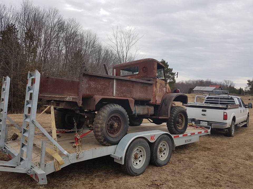

Here are some pictures when I picked it up. It has not run since 1991 or so, It has a 235ci chev engine in it that I was told ran fine when it was parked...although the distributor has no cap or rotor on it and seems like someone was trying to get it going many years ago.
The tires were still holding air since at least 1991.

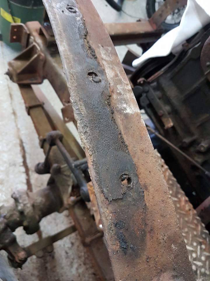

Making some progress with the tear down here are some pics and I should have a video up tonight.
A few questions.
The windshield frame is welded....thos doesn't look factory...or is it.
Where do I find new rubber seals for between the panels and around the windshield.
The bottom corners of the window glass frame were welded and rotten. What are my best options for a new window frame?
And looks like I can use some new door latch hardware.. .any leads?
Thanks!!

The transmission was not originally a SM420. The original was not synchronised. I believe the SM420 is longer than the original which would either require moving the transfer case rearward or making the short shaft between transmission and transfer case even shorter.
Your windshield post does look as if it has received some "added reinforcement".
The latch dovetail looks very similar to that sold by Mac's for Fords of similar vintage. The part numbers are close but not identical.
Yes I can see that the tranny isn't offset like the original according to the hump in the crossmember. I know better what they did once I get the box off....seems like a pretty simple transplant though.

Here's what your windshield post would look like. The 2 slotted screws hold the pipe in the casting. The hex is the remains of a curtain stud for the door windows.

Ah ok that makes sense...tbe part number on the casting and screws had me tbinking. Thanks.
