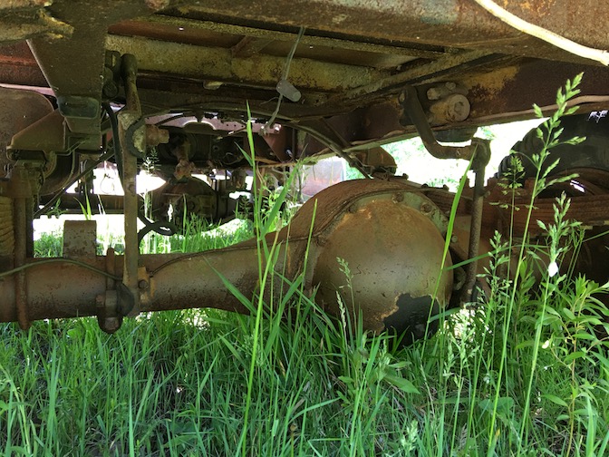

I kind of said that I was trying to thin the herd but I purchased this truck before I made that statement and I was able to pick it up today. What is interesting about it is that it looks to be a Cab11 style, branded as a FORD and powered with a flathead 8. BUT it has a Chev frame plus front and rear Chev axles. Has anyone ever heard of a a "combo" F & C-15A?
I thought only Cab13 versions were available as a mix & match after the war, purchased as a kit that was assembled from the mountain of CMP parts that must have existed, at one time in the past.

A lot of early F15A cab11s had Chevy axles under them. The frame should be Ford though.
My first CMP was serial F10616 if I recall correctly, and it had the Chev differentials.
Old 03-06-17, 05:55
I've seen a Cab 12 Ford with Chev axles. Your air vents are Ford. Chev vents were round.

I have a Chevy rear axle on my Cab 11 F15a

A shortage of Ford axles in the early part of the war meant a good number of 11 cab Fords were built with Chev axles.

Thanks for all your comments. I guess I can safely call it an F-15A - hood badge is Ford, interior decals are Ford and it is a flathead 8. I was after it primarily for the steel body on the back but we will see how the engine. It looks like a Cab12 rather than a Cab11 from the front bonnet. I will check and see if the front window has a hinge on it.
Correct, there even is a list of the trucks which were fitted with Chevrolet axles in the Ford manual, so one can look up if the truck in question was originally fitted with these axles.

I saw your question so I went out and took some pictures of the underside of the Cab11. To me, it looks like Chev axles front and rear, Chev dampeners and a Chev frame........what do you guys think? If so, how old do you think this truck is?

It's definitely a Ford chassis with Chevrolet axles as normal for that vehicle type.Front shock absorbers (dampers) are Ford, rears look to be Chevrolet. I'd be thinking it's a 1940 build.

I agree with Keith, A Ford and probably came down the assembly line at the same time as my F30S seen in posts 11 & 16 above.

In the 4 th photo we can see the builders tag on the side of the cargo box..... have you been able to decipher what information it contains????
One more Ford clue on the underside picture......NO cross member for the winch....
