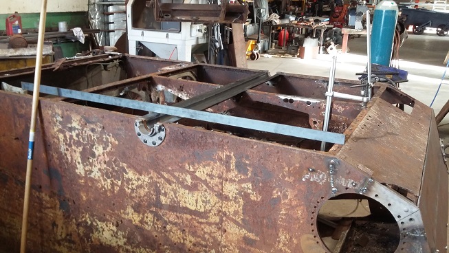

I have now got both of the axle channels in place and some repair to the rear curved floor.
20170531_163859.jpg   20170531_163915.jpg   20170531_163930.jpg   20170531_163940.jpg   20170531_163956.jpg

The floor of the other one is also off. it's not too bad to get off once the rivet tops have been ground down. I still need to grind lower than the flat surface as the rivet sits in a small counter sink hole. Hand chisels, Hammer and air chisel do the job. The side return roller will come off tomorrow as I need to make two of them as well.
20170531_164030.jpg   20170531_164042.jpg   20170531_175924.jpg   20170531_181816.jpg   20170531_183130.jpg

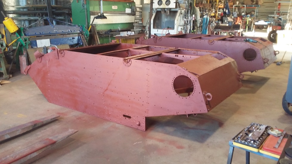

I have completed the hull repairs and they have had their trip to the blasters, back on my truck and now back in the workshop on stands, ready for the resto process.
20170607_111538.jpg   20170608_125236.jpg   20170608_131253.jpg   20170609_170521.jpg   20170609_170613.jpg

Hi jack, even better now with a coat of primer inside and out and ready for the new floor.

Excellent Colin, I see there is still a bit of drilling and cutting to do for the final drive outlets. Keep up the great work.

Hi Rick, no that is how it is. One side is different to the other side as they are both original and I have only repaired some cracks.
