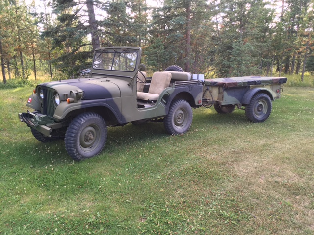

Wayne Hingley's Avatar
Wayne Hingley Wayne Hingley is online now
Posts: 743
Default Made some timing adjustments and...
...took another test drive this morning. Working much better, but not perfect yet. Still a small hesitation, and sometimes hard to start. Ill keep adjusting...
Im not getting enough (or any) vacuum to run the wipers. I may need to rebuild the pump. Unless there are any suggestions on how to improve vacuum.
A few photos from today's drive around the neighbourhood. My two boys (8 & 10 years old) absolutely love riding in the jeep!

I have been putting a few miles on the jeep after getting it inspected and registered. Interesting to note it has never been registered in any province since leaving service in 1987.
I live about 7km from the nearest pavement, which makes it hard to keep the dust off everything... so it shows that it's getting some use (and as Phil notes; a few scratches too).
