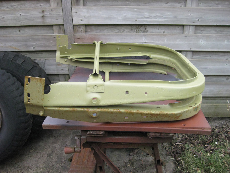

The horseshoe-shaped frame on my C8 was pretty crusty. I was lucky to find a replacement frame from a cab13. It seems the basic pressing on the 11/12cab frame is the same as cab 13....but the brace is in a different location and the open ends are cut differently (picture 2 shows cab13 top, cab11 below).
I drilled out the spot welds of the brace and welded it in the proper location for a cab11 ....than cut the ends to match the 11cab frame and swapped over the missing captive nuts.

  #224
Old 30-05-19, 23:17
Last bit was to make two new panels that attach to the bottom of the horseshoe and the assembly is now patiently waiting for it to be fitted to the chassis when the engine is in.

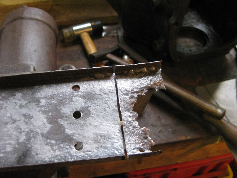

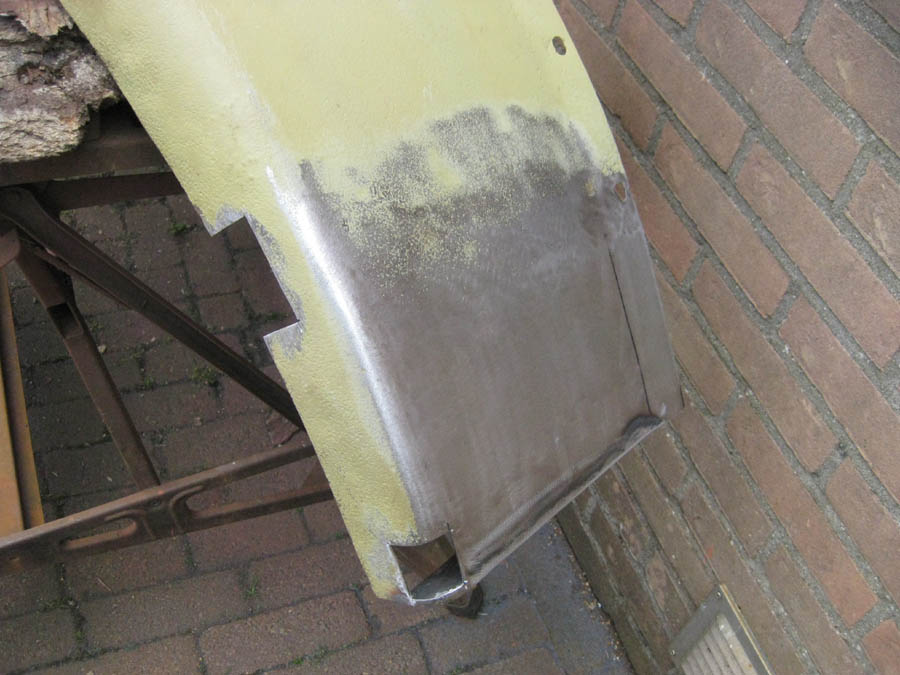

I did the fenders some time ago. In fact....when I see when the pictures were taken....
I had the local steel firm roll a sheet for me in the correct radius for the front fenders, so I could cut repair panels from it.
  #229
Old 13-09-19, 00:33
I didn't have the tools to fold the lower edge of the fender...so in stead I welded a strip to the end of the fender to simulate the fold.

  #230
Old 13-09-19, 00:40
Now for the left side fender....This one was worse. I started by trying to bend it back into shap as much as I could. Than welded in a strip along the edge where it is bolted to the cabin. This time is cut out a larger section of the fender....right to the nicely rounded edge on the front and side of the fender. This was a better approach than what I did with the other fender, as it gives a much nicer result......less risk of a peak where the new metal is welded to the old.
Holes for the fender supports and headlights were drilled after patch panels were all done.
