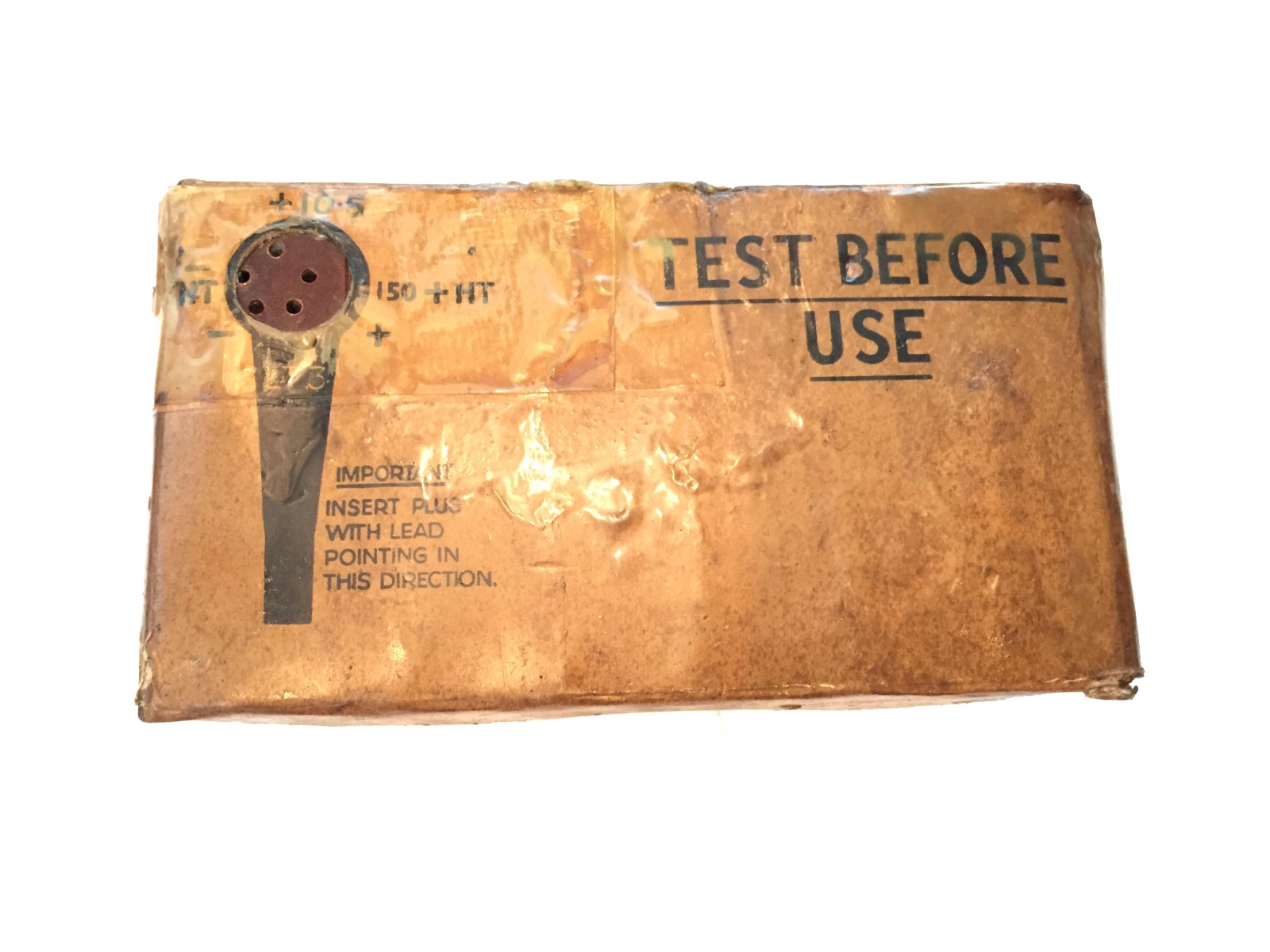

Would any of you know if the pictured battery is a commercial model and/or war time produced? This battery was taken out of a untouched WS18 so it made me wonder as its not 100% identical to the ones showed in other threads here at the forum. Thanks in advance!

For me it's not a WW2 military model of a WS 18 battery, but it's a good item.

That looks like a later 'tropicalized' strap, with nickel plated fittings and rot-proofed webbing.
There were several different varieties of fittings used over the years: plain brass (the original), nickel-plated brass (tropic proofed), tin-plated steel (economy), and painted steel. The tin-plated steel are the worst due to tin being lower down the electrochemical series than iron (so that as soon as you get a hole through the plating that exposes the steel electrolysis can take place and the steel rusts at an amazing rate).
Chris.

Maximum battery dimensions are 4.75" x 4.125", for a circumference/perimeter of 17.75".
The double buckles are standard - they're self-locking so the strap can be threaded through them and pulled tight to hold the battery in place.
I've attached the battery specifications - these are for the final version (with NATO stock numbers, etc.) - the battery stayed in service for a considerable time, as it was used to power other equipment (Field telephone amplifier) as well as the WS18, WS46 and WS68, etc.
Chris.
