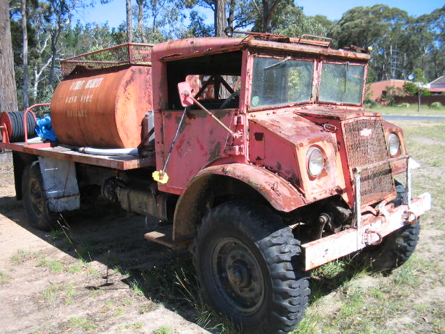

While we're on this topic, the sign below appeared on a Chev Blitz water tanker (original) near home. It is a red diamond outlined in white with a white lightning bolt in the centre. Any thoughts?
Tony would that have been a fire bragade logo as we did pick up one years ago with a smokey bear on the side.

Default ex fire tanker
Hi Tony,
This C60L ex NSW fire tanker wouldn't be the one from the Little Hartly caravan park would it?

Default The all-knowing victorians
Correct!
