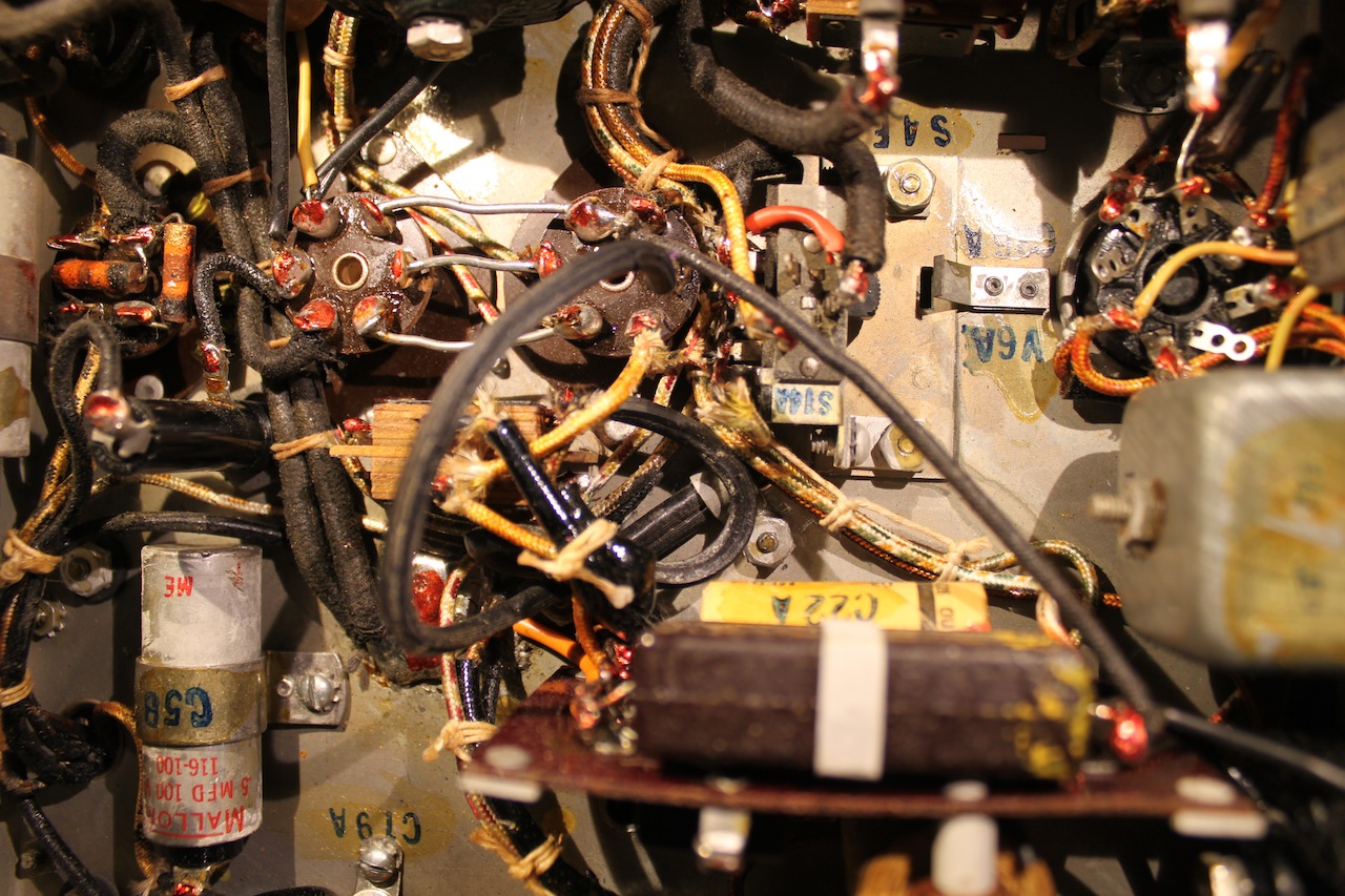

A couple of Sunday morning observations.
It appears these receiver chassis were inspected at a standard inspection station that used a steel stamp punch to verify the inspection. I have found this 5/16 inch stamp on the outer left and right chassis side panels on both the main set receiver and the remote receiver. these two units are roughly 2,000 apart by serial number in Marconi's 1944 production.
The other interesting discovery relates to the Crystal Calibrator chassis in the upper left corner of the receiver. If you check back at the photo in Post #4, you will see a large daub of blue paint on the calibrator chassis at the left end of it. I found the remains of a similar daub on the Remote Receiver calibrator chassis.
This mark was applied at the factory to denote that all the valves in the calibrator have been 'aged'. That means they have been run for 12 hours to ensure the electrons will feel right at home in the valves when they are put to work. In addition, the receiver manual notes that Marconi has aged all essential and spare calibrator valves issued with the set. These valves have also been marked with a blue dot of paint on the end of the locating pin.
Whenever a valve has been replaced in the calibrator, the calibration test needs to be performed. With an aged replacement valve, this test can be done straight away. If the valve has not been aged, the calibrator needs to be run for 12 hours before the test can be performed.

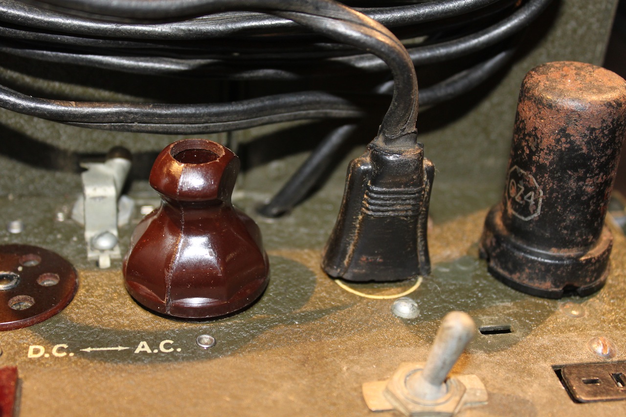

Another week. Another adventure.
As I had mentioned earlier, I want to first focus on getting the Remote Receiver back up and running. There do not appear (so far) to be any electrical issues. Most work will be cosmetic and physical in nature. However, at some point I am going to have to chase electrons into it and see what they get up to. Towards that end, a huge piece of the project arrived last week…a ZE 11 Remote Supply Unit.
I had known about this item for a while, but was also aware it related to the Wireless Set No. 9 Mk. I Cdn. The ‘correct’ Remote Supply for the WS-52 is actually the ZE 12. Then I learned from Jacques Fortin, out Quebec way, that there are only a few minor component variations between the two supplies and in fact Marconi had shipped ZE 11’s with initial production of the WS-52, until production of the ZE 12 was ramped up. So I bought this ZE 11.
Externally, the supply shows the usual dirt and nicotine accumulations for its age, but overall the original wrinkle green paint and white silk screened markings are in excellent condition. The underside of the cover assembly is finished in a very fine textured silver/grey metallic paint. I am curious now if this finish was also applied to the interior of the main set carriers and the remote receiver case.
The OZ4 looks a bit scruffy and has not yet been tested. The Serial Number (3892) has been stamped on a small metal plate which was then riveted to the top of the Choke cover, over top of the white stencil that notes a location for a serial number. I am wondering if initially these supplies just had a painted on serial number and then later Marconi switched to a metal plate format to extend the life expectancy of the identification?
The outside top of the cover has the number ‘3820’ hand written in white on it in two separate locations. Possibly a cover from a doner supply.
The AC cord is original, measuring about 7.5 feet. It had electrical tape wrapped around it a couple of inches above the base. At first I though this might be hiding a splice, but a closer look indicates a rodent of indeterminate size appears to have used the cord as dental floss at some point. I will have to take a closer look at that later.
In any event, it seemed the right idea to get this supply checked out and working as the first part of getting the Remote Receiver back up and running. Same initial goal, just a slightly different start point.
WS-52 ZE 11 Remote Supply A.JPG   WS-52 ZE 11 Remote Supply B.JPG   WS-52 ZE 11 Remote Supply C.JPG   WS-52 ZE 11 Remote Supply D.JPG   WS-52 ZE 11 Remote Supply E.JPG

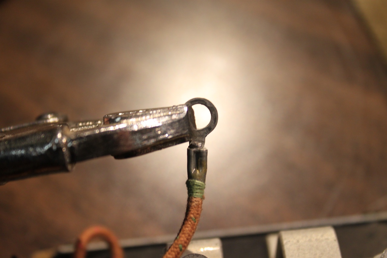

While rummaging through some more wireless bits boxes on the weekend, I rediscovered an old project package I had abandoned umpteen odd years ago, Trying to put together the really good parts from several Key & Plug Assemblies No. 9 Canadian, to make a good one for one of my 19-Sets. I think I stumbled across a very good assembly at a local sale and work on the project halted.
As it turns out, one of these Key and Plug Assemblies is needed for the 52-Set, and since I cannot do any soldering until my new soldering station arrives, I decided to reactivate the work needed and put a Key & Plug Assembly together for the 52-Set.
The project was simple enough, involving the transfer of the plug and cord assembly (in good condition) from a scruffy unit somebody had cut the leg straps from, to a very good unit somebody had cut the plug and cord from.
There are only two things that are a bit tricky about the work needed to be done: the two terminals on the positive and negative cord leads are crimped to the leads AFTER the cord is fed through the grommeted opening in the key base plate at the factory and they are too wide to slip back through the grommet as is, and secondly, there is an anti-strain loop woven into the cotton cord loom that slips over a J-Post Bracket at the back of the key bar assembly, just inside the case, This cotton loom is now some 60+ years old and is often not up to liking a lot of pulling and tugging, without breaking.
Step one is to remove the two terminal screws for the positive and negative leads. Make note the negative (earth) lead is the front most one. It has green cord wrapped at the base of its ring terminal and a green tracer woven into its loom. The line directly behind it is the positive one, with a red cord wound at its terminal lug and a red tracer woven into its loom.
Once you have removed the two leads from their terminals, remove the terminal screw on the back of the J-Post. It is only there to secure the anti-strain loop that has been slipped over the post. You will have to feed about one more inch of the plug cord into the key assembly at this point to give yourself enough loose cord for slipping the anti-strain loop off the J-Post. Once it is free, you just have to deal with the two terminal ring lugs.
The best way to remove the two leads is to hold a ring terminal with a pair of pliers, on one side of the lug, about one third of the way across the ring, Then take another pair of pliers directly across from the first and GENTLY and SLOWLY bend the ring to form a gradual, near 90 degree bend. You just want the diameter of the ring to have reduced enough to slide out through the metal grommet. Do the same to both ring terminals and you should then be able to remove the plug cord from the key assembly. Best to do it strain loop first and then one electrical lead at a time.
Reverse the process into the good key assembly. Insert enough cord that you can easily slip the anti-strain loop over the new J-Post and then gently snug it back. To reflatten the two ring terminals, I use a pair of needle nose pliers that have a smooth inner face to the jaws down near the jaw pivot point. Or, I sneak a pair of Debbie’s jewellery pliers that have smooth faces to do the job.
A couple of other points on these Key & Plug Assemblies. I have seen them with and without the bakelite guard fitted to the key bar, under the bakelite knob. I am not sure if this is just a case of these guards sometimes ‘disappear’, or if it reflects a change in production, with early morse keys lacking the guard and it being added later. No big deal if you never plan to use the key, If you do plan to use the key for CW work on a restored wireless set, I highly recommend you find a guard and install it.
Ever noticed the funny looking bakelite finger guard surrounding the morse key socket on the Mk III 19-Set? It is usually not there on the Mk II Set, which normally has either nothing, or a simple flat rectangular bakelite plate around the socket.
When you are working CW on a wireless set, the Send and Receive functions are controlled by the key plug. Fully inserting the plug places the set into transmit mode, pulling the plug half out of the socket places the wireless into receive mode. In Receive mode, one half of the brass plug assembly sits exposed outside the front panel of the set. If the wireless operator is in a hurry to transmit and pushes the plug back in with his fat fingers in the way, he will find full transmit High Tension power arcing into himself very quickly. Hence the development and installation of the finger guards. And the guards are great, but not perfect. The one on the Morse Key Bar and the knob will only protect you for the first 8 Amps. After that you are on your own.
Wonder how many wireless operators had their key strapped to their thigh first thing in the morning and spilled their cup of tea on their lap? Be more than their Rice Krispies going ‘Snap, Crackle and Pop’.
Hope this wan't too long winded.

Old 12-02-18, 22:45
Junior Password Gnome
Location: England
Posts: 882
Ah, you're fitting the cable backwards!
Replacement cables would be supplied with the appropriate tags on both ends, the key end would be attached first, and the cable fed through the grommet, after which the jack plug would be fitted to the free end. Workshops (ant telephone exchanges) had a hand-cranked jig to assist in screwing the jack plug on to the (ready made) cable, after which the crimped-on terminals would be fixed to the plug connections and the plastic cover screwed home.
I'd like one of those jigs, as I have replacement switchboard cables (in Chinese Red only, so far) to restore my Switchboard UC and its severely moth-eaten cables with.
Original British keys used the No.10 plug, which provided adequate finger protection. The Canadian keys had a more exposed 'hot' end, and the set was fitted with a plastic guard to reduce the risk of a 'belt' from the buffer stage HT (250 volts or thereabouts). I can't remember what the American keys used.
'Ham' modifications using commonly available jack plugs are a recipe for disaster if used by the unwary: Post Office style jacks with exposed screws (and the tail end of the brass body) are a hazard, and I hate to think of what the modern "all metal" screened plug would do to the user!
Chris.
