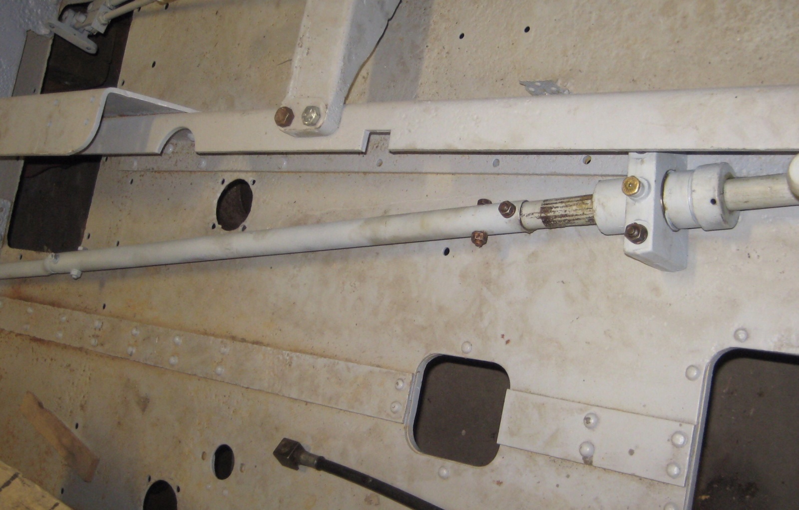

still making progress. working on linkages and pivots. took the front armor off to get at the floor. the screws for the pivots were rusted good. so i had to tac weld the heads to remove the nuts.

so after looking at the center divider i decided to make a new one as i think it will be easier than repairing what i have. the rivets came out surprisingly easy, not complaining. there was some damage to the strip that covers the seam on the floor. decided to cut out a section of strip and replace that too. there's a little rust on the hull floor but it's not worth pursuing. getting close to blasting time.
