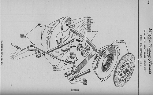

Default Something is out of line
Hi Harlé
The video sure helps explaining the problem, it does look like something is out of line. Not having Ford it will take look at the manual which I did when I looked at the manual found that clutch assembly is not unlike the whole setup in my 49 Lincoln which basically has a Ford Truck engine.
It does in deed look like something is bent, worn or out of line.
Name:	Ford Clutch.jpeg
Check my logic guys
7508 Bushing on both sides, as the load is all forward on drivers side and mostly backwards on the passenger side would tend to wear on one side.
7510 Shaft with even the slightest bend would make the lever arm 7511 look like it was bending as rotation. This shaft could be bent if the linkage 7531 up to the clutch peddle was allowed to over travel. Is it just a trick of the photo that your linkage looks like it has been welded?
You guys with the Fords will have to step in on clutch adjustment how you set it up so that it disengages near the top of the stroke yet the peddle hits the floor/stop before you are trying to over rotate the fork shaft causing it to bend.
If all of those parts are OK then check the pins 352581-S are they worn or have the worn the shaft holes to allow play.
Keep us posted on your progress.

Hello Harle,
I looked at the video, good suggestion Phil and as Richard pointed out the pull rod seems to have an excessive bend in the middle which is causing it to flex when under load.
I looked and the one on my truck and the spare one in the attached photo and they are mostly straight except at the clevis ends where they are slightly bent.
I assume this is to allow for the two levers not operating in direct line with each other.
Also Harle, yes, the red wool hat was his trademark, but I haven't started wearing one just yet. Maybe as my hair gets thinner I too will don a red woolen hat. I then might get more done in my cold garage in winter too.
F15-A 1942 Battery Staff

Hello
Problem solved!!!
thank you all for this Help I was afraid to change my Clutch ,It is a bren new french one but I was not sure that it was exact the same .
The rod was completly damaged , it looks original angled , but was not...
Your picture was very usefull Jacques!
