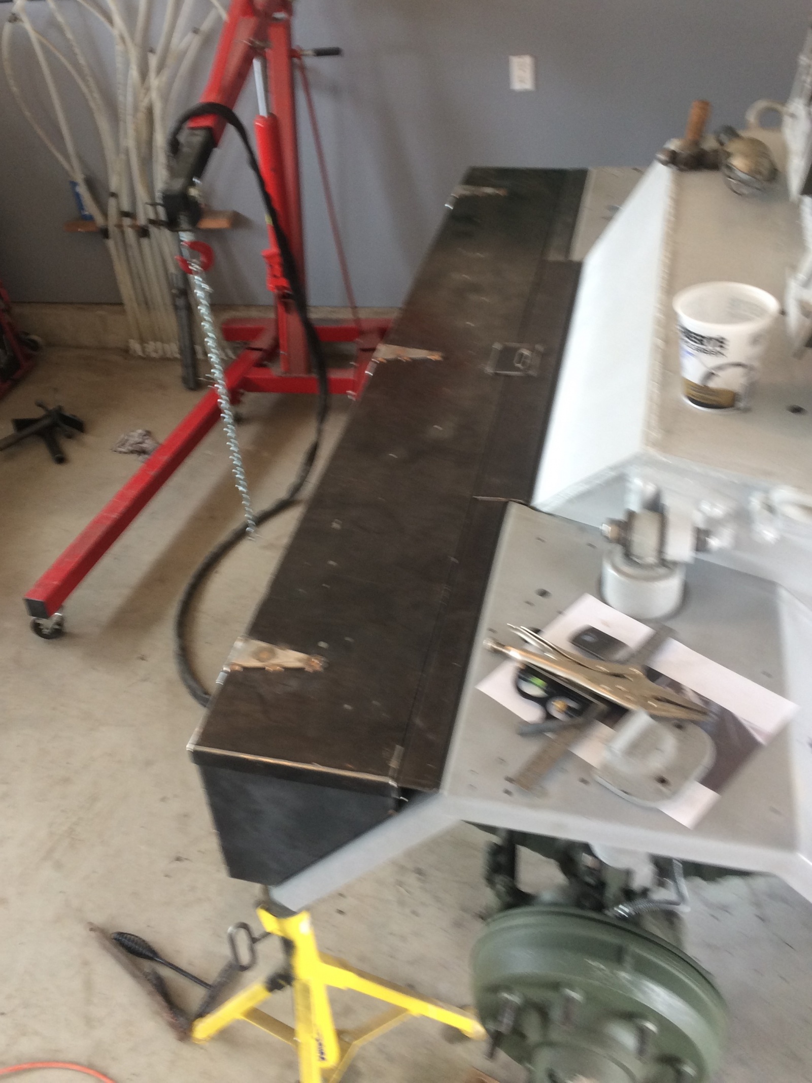

  #577
Old 27-03-18, 23:59
Join Date: Apr 2011
Location: Cherry Valley, ON
Posts: 554
Default Mock up
Guys,
Mocked up the new front storage bin that Andy fabricated. More work to do on the lids and it's extensions, but definitely looks the part. Changes the appearance quite a bit.
Peter
