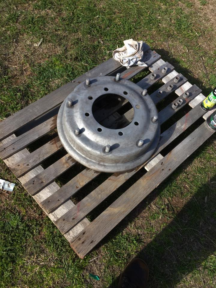

So ive been poking away with the sandblaster when I've had time doing a section and priming it.
Ive also robbed the dog of his outside hut as it makes a brilliant blasting booth he's not very impressed and took to sulking under the Blitz
so the loose rim is cleaned primed and the nuts painted up just waiting on the Khaki no.3 to arrive
37956504_2112055642151521_1964220760734040064_n.jpg   37904693_2112055638818188_3372996465050779648_n.jpg   37914035_2112055555484863_8137391355652472832_n.jpg   38492589_2129101273780291_5223408576785022976_n.jpg

Good day Nathan,
You have a nice little truck that has been reasonably well looked after.
I am very impressed with the sand blasting, would you mind saying where you got the sandblaster and what brand it is? if you don't want to put it on the forum would you mind sending me a pm.
Sand blasting of small items, well any item, is getting very expensive and I would like to get a small sand blasting setup that will work.
Ken

Hi Ken,
Not only air supply, but the gun and nozzle.
I purchased a cheap Chinese cabinet set-up that worked only so-so, then a friend put me onto a US-made gun with replaceable nozzle (either steel or ceramic) and a new 'anti-kink' pick-up hose. It now works really well for short sessions, and for long sessions so long as I keep the air supply dry. I have three small condensers and a condensing chamber in the line, and run the pipe from the compressor through a cold-water bath (5 gal bucket with ice bricks) on its way to the condenser. Works a treat at keeping the air dry over a prolonged period of blasting.
The mob I got the gun, etc from was TPT Tools:
http://www.tptools.com/Sandblast-Cab...-Supplies.html
Nathan: how do you catch the sand blasting medium for re-use?
