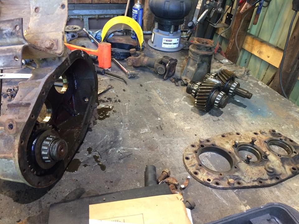

Has it really been since late April that I’ve worked on the truck? I guess so. It’s been a rather busy spring here doing all new gardens at the house. I’ve also been busy making a mini fire truck bed frame racer for a charity event coming up this weekend. Thankfully the build is finished and that project is out of the shop. Now back to CMP’ing.
Today I’ve been working on taking apart my transfer case. So far everything has come apart easily and the insides are very clean. I think I’ll just have to replace some of he bearing cones as a few rollers have some pitting. The bearing cups look good. One question is can I press them out to sandblast the case then press hem back in again? Or would I be better leaving them in and just taping them off?

  #413
Old 20-06-18, 03:12
Default Bearing and race.....
Hi Jordan
Whenever you replace a bearing, be wise, and get a new matching bearing race.
You really do not need to sandblast the inside but if you do you must make sure that all the grits gets washed out which means removing all the cones, identify where they go and it's matching bearing....... same applies to all the shims...keep them sorted by location in a zip lock bag.
When I did mine I replaced all bearings and race and used Speedy Sleeves on the worn yokes with new seals. Once the bare inside was sandblasted I degreaser, acid washed and sealed the castings inside and out with POR 15. Did the same for the tranny and the bell housing. Overkill I know!!!!
GBS should be able to find you all the bearings, race and Speedy Sleeves if not by part number by size....ID...OD.... height.
The joke around the barn is that I took my t case apart and reassembled it seven times before I was happy with all the preload on the bearings....... the seventh time I had taken apart a separate t case just to make sure I had everything in the right order......... runs fine now....... hey what else can you do during the cold Winter months.
Enjoy
GBS

Old 20-06-18, 05:09
Posts: 4,189
Just ordered all new bearing cups and cones. I should have them sometime next week.
Bob, when you say you used Speedy Sleeves, did they replace the original leather seals? Do you have part numbers? I was checking the shafts and they have a visible worn spot where they would seal on the leather. I presume this is what the speedy sleeves would fix?
As for using the engine stand....I thought about that but my engine is still mounted to it. With the transfer case in my bench I find it handy enough, especially when I drop something it only falls a few inches to the table top.

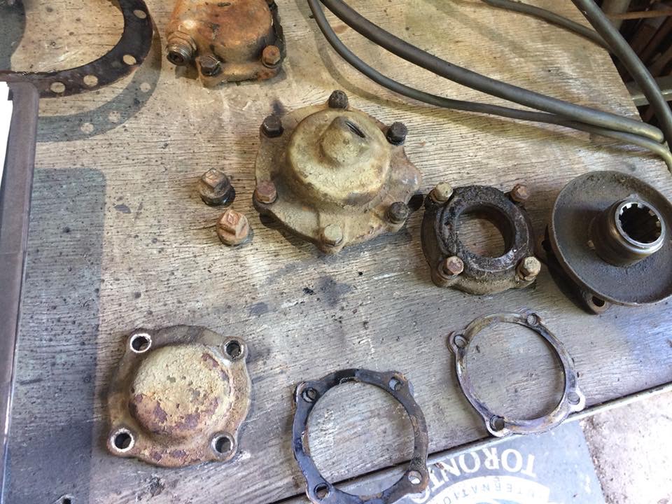

Old 20-06-18, 19:15
Posts: 4,189
I just spent sometime power washing most of the transfer case housing parts. They spent a night in some parts cleaner to try and loosen up the gunk. Next up is taking part the de clutch housing. I’m thinking a new seal is in order by the amount of grease and gunk visible on the outside.
56CB4164-E771-4213-BC38-CBC04F6F9B03.jpeg   8FE523AC-9A16-4FC6-8EC8-24BD53667391.jpeg   5DC3F0B4-58A6-4266-BAEF-A7B3421D574E.jpeg
