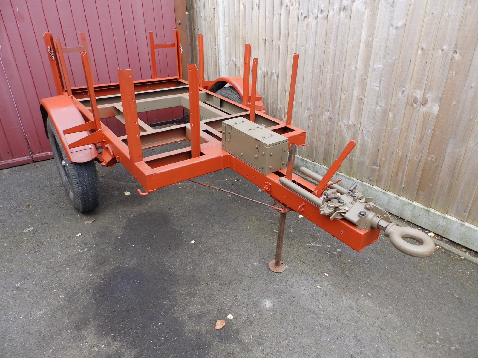

The 10 cwt trailer is finally coming together, see attached picture of the tailgate and sides. Next task is to finish off the mudguards, and then onto painting.

In between carefully cleaning the cushions , I'm now onto marking the 10 cwt GS trailer with it's census number (s).
Question is, was the census number applied to both sides near the front, OR only on the tailgate ?, as I have seen both census numbers on the side and not the tailgate, or, on the tailgate and not on the sides. HELP !!!
As always, thanks in advance.
Keith

My understanding when I did my trailer last year is that the number was on the tailgate and offside of the trailer. Not a result of any definitive research but from discussions with other trailer owners.
