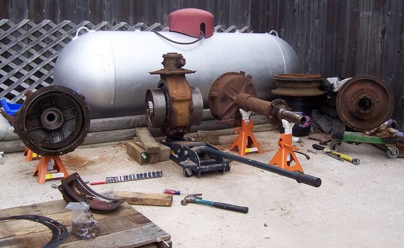

Sorry, can't help with that one. What I have are A-333947 and two are required per vehicle. If you have any traces of oil in your axle shafts, then you would need them as the pressure ruined them all. Never seen the seal you are looking for and the ones that I have are the only source for them as they were a T-16 special pattern that nobody else has.
Best option will probably be building a seal from leather and making sure you don't overfill the pumpkin. Also verify that breather is functional.
Good luck, having completely rebuilt mine in the past, its some heavy lifting.
