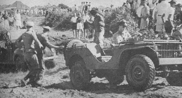

According to the caption with this NEI picture (see the Overvalwagen Forum) this Ford GP is towing its "competitor".
What truck is that to the left? Could it be the elusive Ford/M-H light truck? Compare the headlights, the seats, is this some 1940/41 commercial model under trial by KNIL? Or am I seeing things?

Evening Nuyt:
Well, it is difinitely a 1940 Ford Kubel of some sort.
Not having the magazine to hand, it is hard to tell but the uniforms look rather American to me. Can you give us what the caption says and perhaps fiddle around with the image to get a better view of the second vehicle. You have the original so it would come out better if you did it. I will also have a look see to see if I can come up with something similar. I do not think it is that other Ford/MH you are seeking info on but I can certainly be wrong.

Default better picture?
I did fiddle with the pic but it does not help much.
I still think it might be a Ford/M-H machineguntruck.
It looks like a mg mount to the right of the driver.
The windscreen is similar to MH's.
Dunno...
