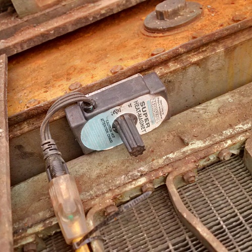

Malcolm
We have been running our centurion at least once a week, we try to get it fired up and run it around the property for 30-40 min (best chore ever) Fortunately Rick had all the fluids topped up and the coolant was good to -25c when it arrived, which if we ever see -25c here on the west coast I'm going to buy one of those stupid Donald Trump hats and move to Arizona, but I digress. As the shop is jammed full the Centurion has to live outside and in the interest of easy starting we keep a C-tek battery charger on each battery, a small thermostatically controlled electric heater in the fighting compartment keeps the moisture away, especially the "sweats" you get having the tank tarped in this humid climate, and finally two Temro heater magnets attached to the radiator header tank, this keeps the coolant warm and boy does it make the tank easy to start. I was going to add one to the oil tank but currently it is just too oily in the engine bay to be safe, perhaps once we get a chance to steam it all clean.
John
