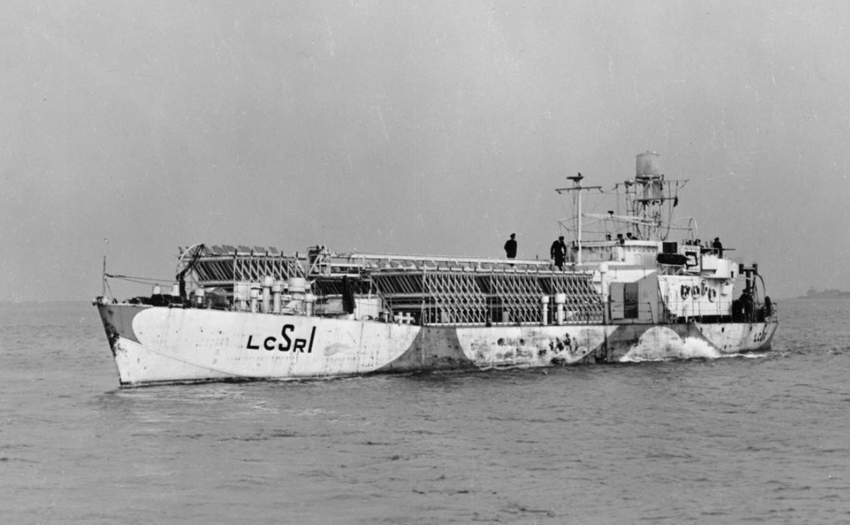

Attached is a picture of Winston before being stretched and still under the old name "Victoria Regia". Also attached is an IWM picture of an LCG (M) and an LCS (L)....as a Rocket ship. I actually think the LCG (M) and LCS (L) might have used the same hull, but I haven't found any measurements or info to confirm this.
An LCSR survives as a house boat in Stockholm, by the way!

Nice photos. It is a Landing Craft Gun(Medium) as you thought.
The Landing Craft Gun(Medium) and the Landing Craft Support(Rocket) did use the same hull.
Only two of Landing Craft Support(Rocket) were completed.
I am not sure if the one in Stockholm is a LCS(R) or a LCG(M). It is marked up as “LCSR 3” for some reason.
