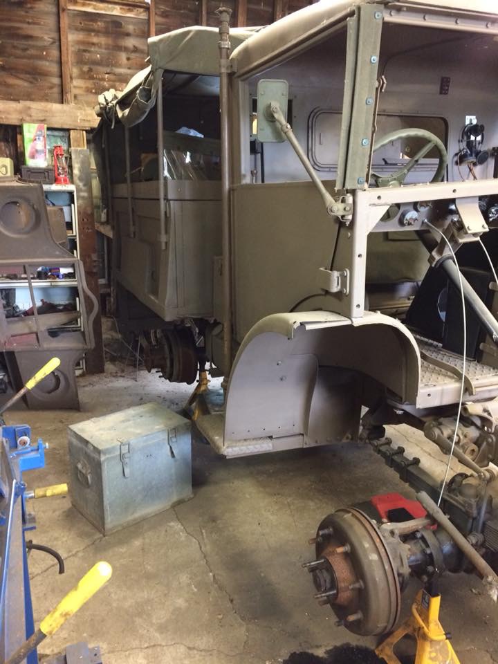

The transfer case is now all mounted. It proved to be quite the job in getting it all lined up and installed. Now that it’s out of the way I started taking the wheels off. All but one came off. The last one has proven to be incredibly stubborn.

Brake drum issue? See if there's any way to retract the (probably stuck) brake shoes. I've wrestled with your problem more than once. Oh, and don't drop the whole thing on your head seeing as three quarters of it is supported on axle stands (if it was me I'd put the other three wheels back on before going aggressive on the last one).

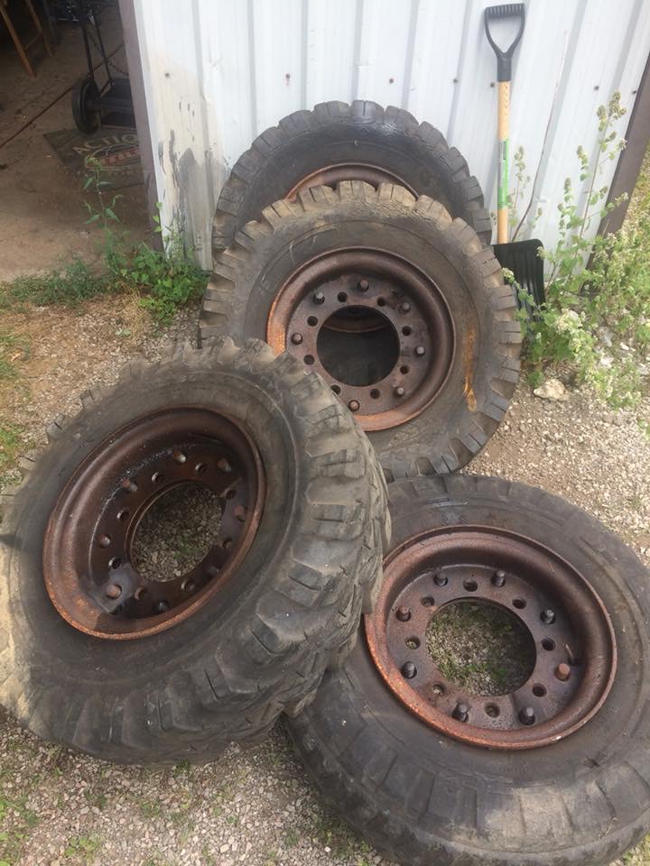

Finally after a lot of work the nuts are all off. A lot of heat from the torch was used and things slowly loosened up with an impact gun.

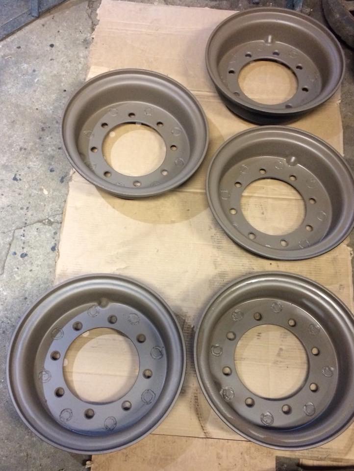

So the rims are out. My tire guy got all of the rims out of the tires last night in about 20min using a heavy truck mobile tire service truck. Apparently having the rights tools did wonders and saved a whole heck of a lot of work. So this morning I loaded up my Jeep with a pile of parts and dropped them off at the sandblasters. 2hrs later he calls to say everything is done. This afternoon I did the usual paint prep stuff and sprayed on some gloss DOM16 (Cnd equivalent to POR).

These rims are all stamped “General Motors Canada, 1941”. The outer clamping bolts/nuts are 7/8-11 BSF. The studs to hold the rims to the hubs is 5/8-18 left and right thread depending on what side of the vehicle it’s on.
The rims are all now painted. Next up will be cleaning the threads in both the studs and nuts then installing the tires.
